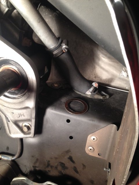

I had to add coolant at the end of the year, couldn't find a leak and never noticed any coolant on the ground after sitting in the garage. Figured I'd check all connections and surely 90% of them I was able to get a full turn. The ones in the pics which are hidden behind the clutches were in the 90%. My thermostat housing wasn't tight either. Hopefully that explains the missing coolant.
