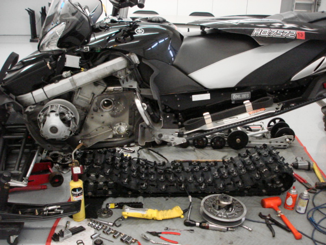

Here are some pics of my 6,000 mile maintenance project. I figured that since there is no snow I may as well have some "fun" working on my sled!
Shocks sent to Pioneer, several bad wheel bearings to replace, slides, rear suspension bushings, Ulmer front end bushings, all driveshaft & jackshaft bearings, change the fluids, lube everything, etc...
This may be a bit extreme but I would rather take the time and spend some money now than to have a sled trip ruined because of a preventable break down.

Is that a garage or a museum?

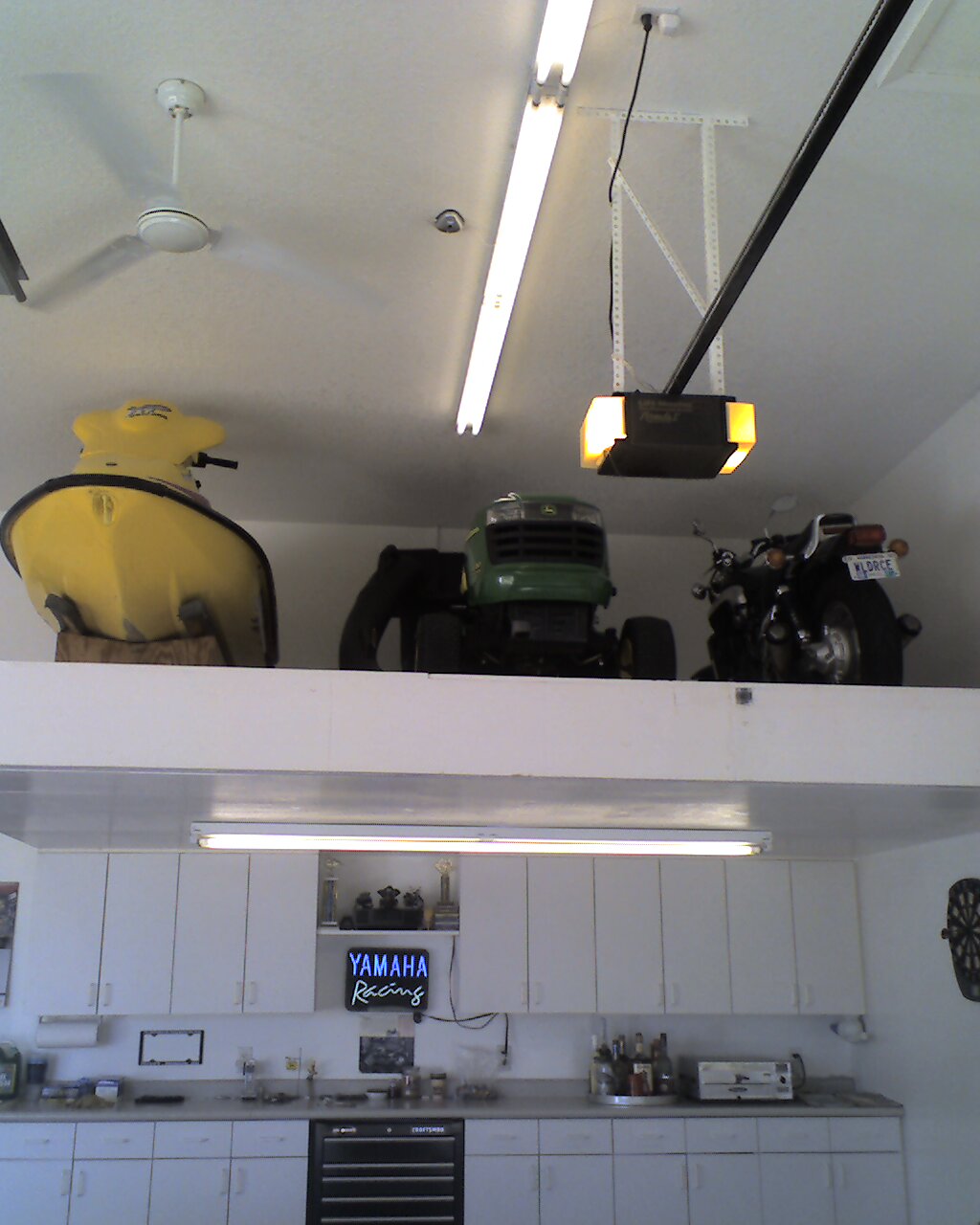

Is the pic in your avy your garage too? If so how do you get the sleds ups there? I am thinking about building one for my Attak

Blue Dave's man cave is awesome!!!

I made an aluminum platform that is lifted up and down on a four point harness by an electric chain hoist in the ceiling. I can get four sleds up on the storage loft by alternating them facing in and out.
When the platform is lifted flush with the storage loft then two bolts secure it to threaded mounting plates in the loft beam and then two legs on the other end of the platform swing down and lock in place.
Once the platform is bolted to the beam and the legs are locked in place then I can release the four point hoist harness and the platform is free standing flush with the storage loft.
The sleds are on rollers and they are rolled on and off of the platform and lifted up and down. In the winter I put the summer toys up there. It really saves on the floor space in my garage.
