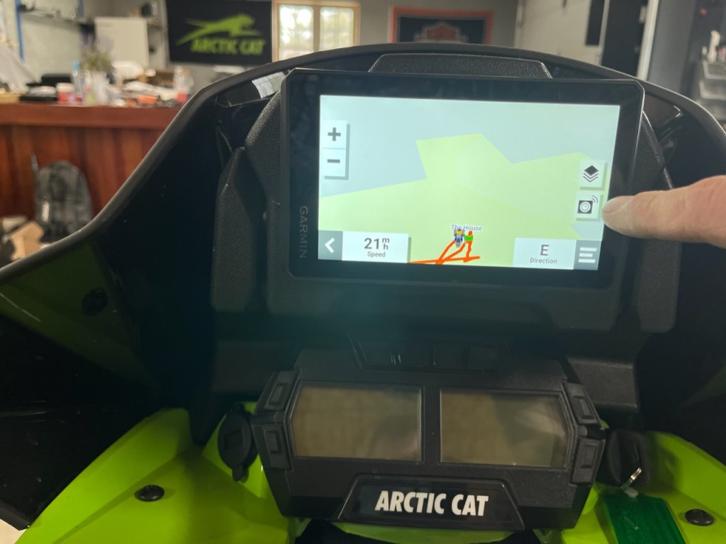

Arctic cat dash caddy
The advantage is pinch to zoom, edge to edge screen and just better resolution. Just no specific ram mounts but the clip that goes to ball mounts
Everything runs throug the clip for the back circle. No cradles. The little circle thing is the clip.

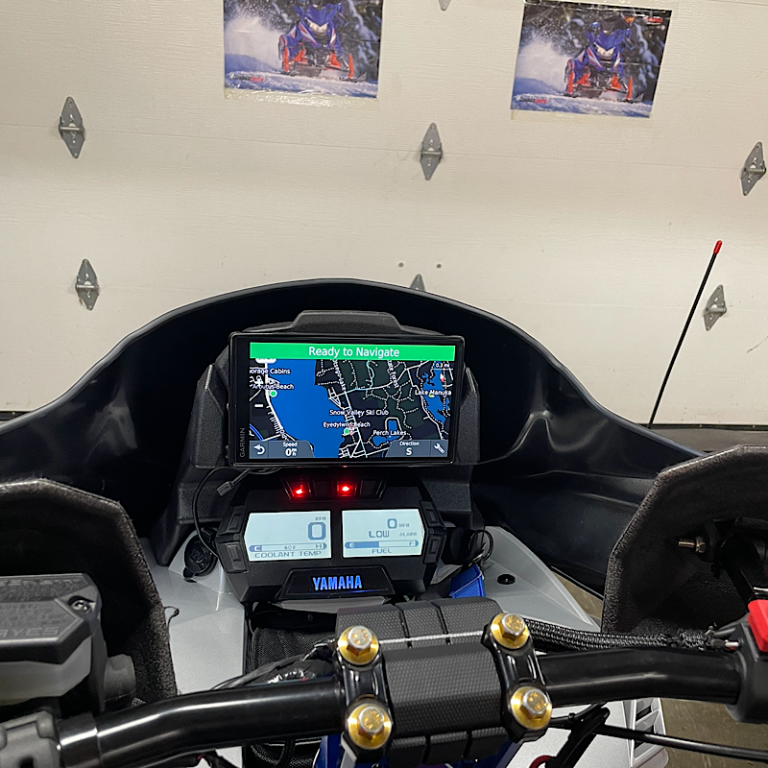

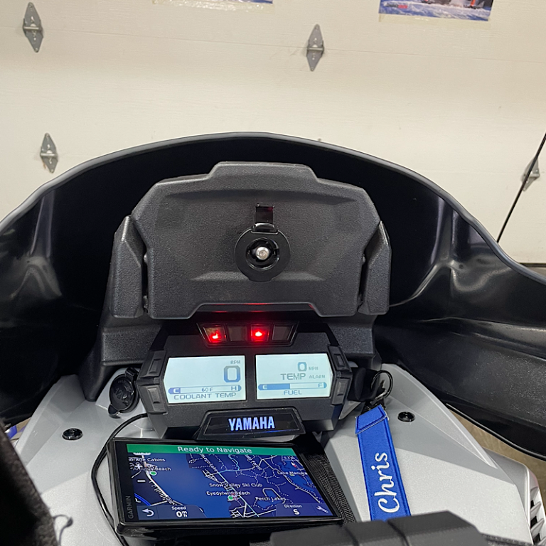

I just did the dash caddy mod last night. Went pretty good. A little unnerving drilling a 3" hole only to find out the vent they gave you is 2.75". And then realize the 3" hole is just for air movement and the vent goes into the caddy.
Otherwise no issues. And I went from a 4" Nuvi to a 6" Garmin Nuvi like the one I have on my Apex. I mounted the cradle as high as possible as no to give as much clearance for the door and maintain view of the gauges and idiot lights.
Here are some before/after and progress pics.

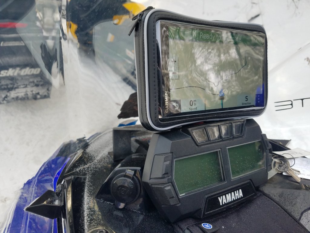

Here's my GPS mounting. In a waterproof case with a 12v 5w heater to keep the display bright in the cold. Mount is from BOP.View attachment 165583View attachment 165584I'm glad you posted the dash caddy, I wasn't even aware it existed. Seems like a good option for extra storage. Thanks!

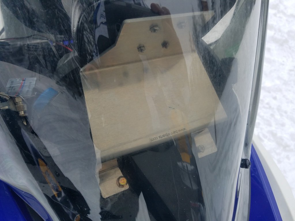

And BOP mount is that? Can you provide a pic thru the windshield to have a look at the mount. Thank you
