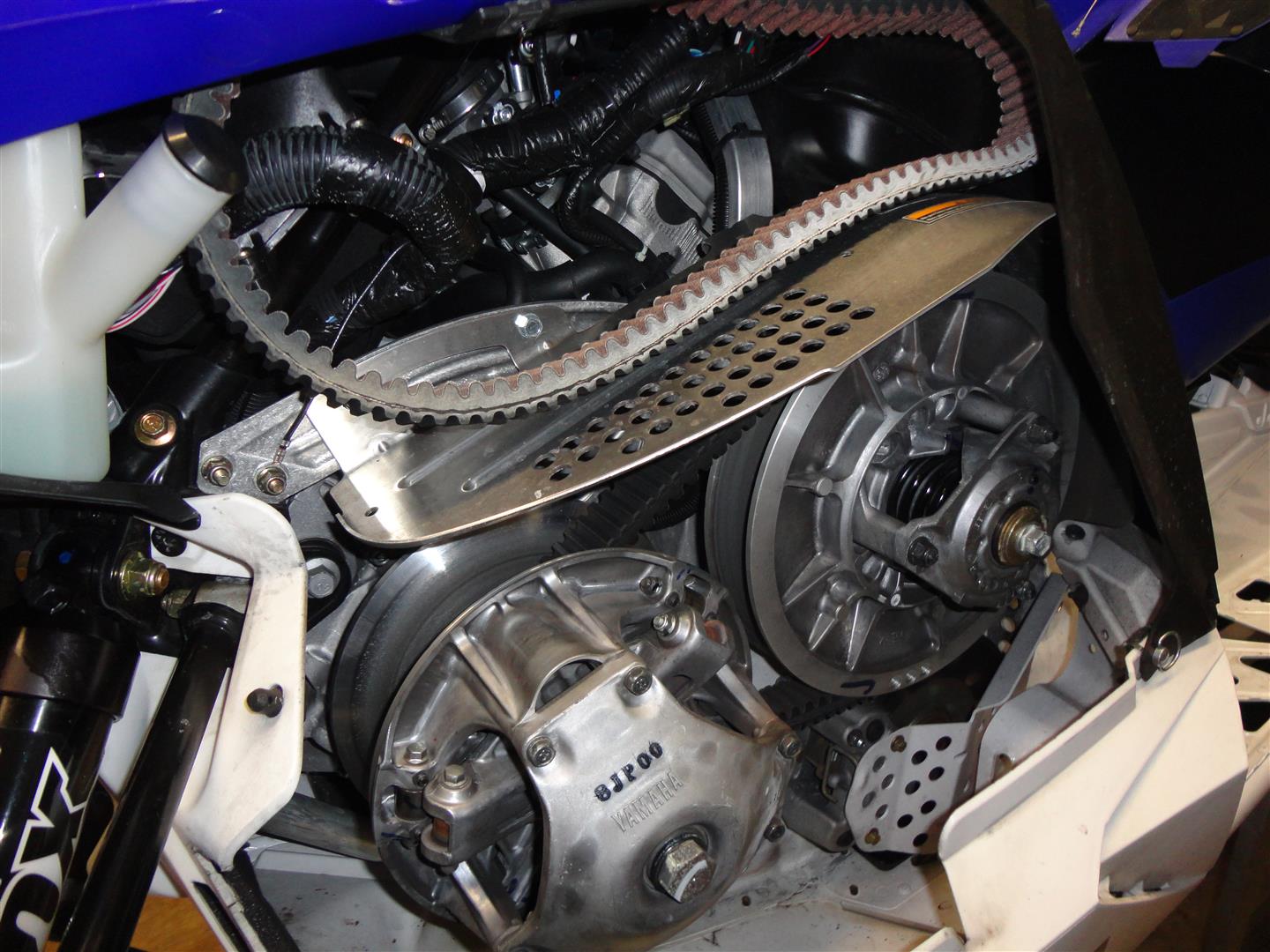

cannondale27 said:I didnt post this since I wanted to see how it worked. Over 500mi on and no issues with belt just put in here like so. I jumped it many times no issues. Simple.
I did mine the same way. I have three tie straps holding the belt squeezed. 400 miles. No issues.
I did my Nytro the same way.

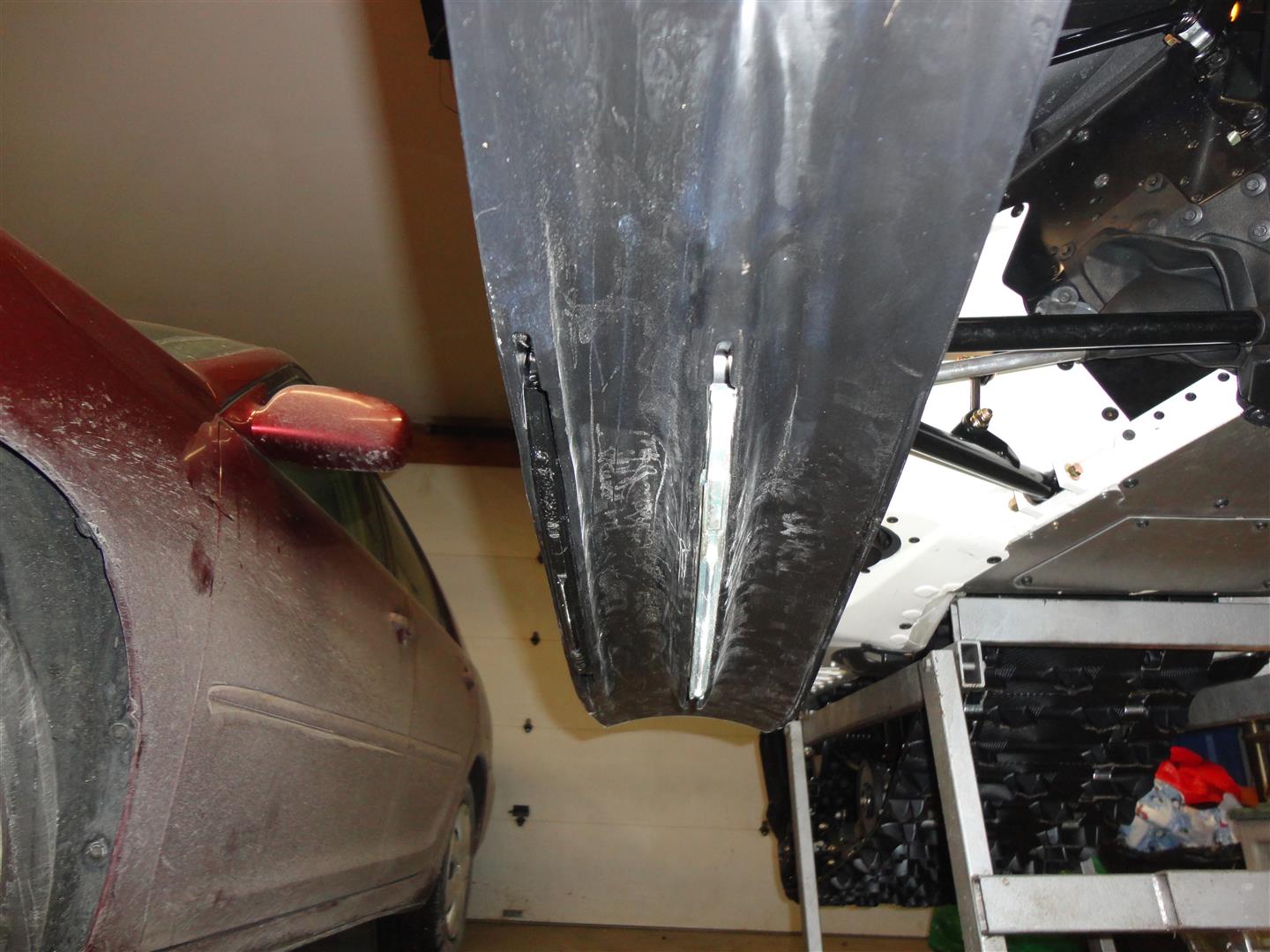

Now I can move on and put those Evols on. Surprisingly I bottomed the whole sled 2 or 3 times this morning at high speeds. Never thought that would happen since it was so stiff in the beginning. Only took a couple pics since time was short but this is how they were and NOBODY out, They must have partied to much! Happy New Year!
