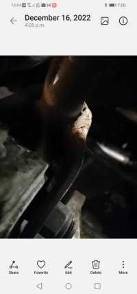

At front by inter cooler

Just an FYI here. Had a 17 Winder in today blowing the ignition fuse. We found a wire in the main harness was rubbing through on the frame portion of the front left engine mount.
