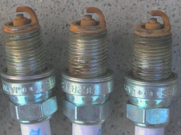

I can't tell from your picture if you had any detonation. How did the tips of the electrodes look?
Not my plugs....(the picture of the plugs came from a Subaru WRX forum)

Hammer,
You wouldn't by any chance have a link to the thread would you? Like woodsrider said; I too am having a hard time telling if there was detonation. I would like to personally talk to this guy about his experiences with the Torco concentrate. I have talked back and forth with the Torco techs and they swear the concentrate is just that; super concentrated race fuel rather than an off the shelf octane booster.

I've personally tested Torco octane booster and it does nothing. This wasent just SOTP testing, it was looking at how much timing was being pulled from a eninge that uses very accurate knock sensors...the timing being pulled at a given boost level was the same with our without Torco. It does nothing other then ruin your plugs...

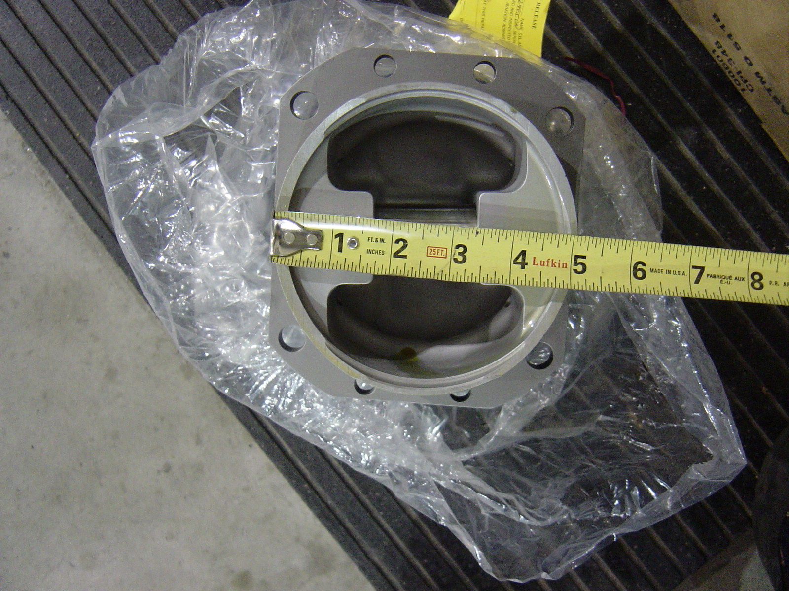

As far as aviation engines using small pistons, give me 10 minutes and i'll prove that wrong, also..
Here is a picture of a very common airplane cylinder and piston:

Travis, after reading that quote I thought it was more than likely backwards. Most planes I have been around all had long stokes and large bores. This explains slower revs that AV is designed for. The product I am asking about is not an octane booster it is (according to the guy I have been e-mailing back and forth with and their web site) a concentrated version of their Mach series leaded race fuel.
