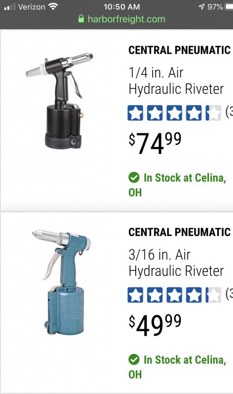

That’s odd. Both the 3/16” and 1/4” air riveters show in stock at HB at my local store:
