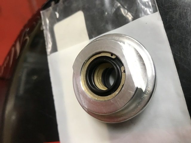

You guys know I have a Billet sealhead for that center shock which uses actual FOX F.I.S.T. Seal and Scraper system?
FOX Ice Scraper Technology (FIST)
Our patented FOX Ice Scraper Technology eliminates moisture from entering the shock by scraping off snow and ice before it ever interfaces with the seals. The bushing fit is also a tighter fit to shaft than most of the stock sealheads which vary greatly. This shock still is doing a ton of work for its size but these definitly help. This is the same system the QS3R Center shock uses.

What’s it worth ?You guys know I have a Billet sealhead for that center shock which uses actual FOX F.I.S.T. Seal and Scraper system?
Our patented FOX Ice Scraper Technology eliminates moisture from entering the shock by scraping off snow and ice before it ever interfaces with the seals.View attachment 169438
$50 and the refresh of $30What’s it worth ?
