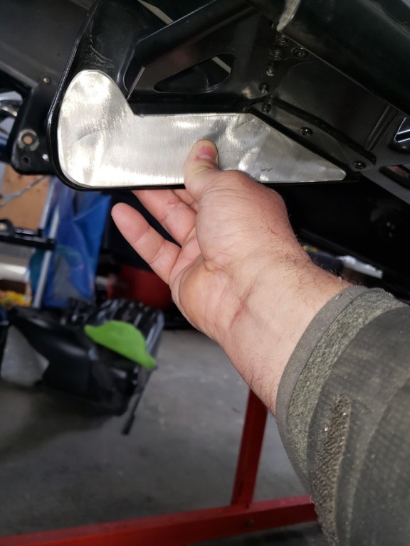

Here is a rough cut of the bracket reinforcements I am making!!
Still needs to be trimmed to fit perfectly , drilled
then powdercoated

Almost fitted bit more grinding

Looking goodAlmost fitted bit more grindingView attachment 155089

ThanksLooking good![]()
Hellflyer (member here ) just contacted me and is sending me aluminum brazing rods to try to plug the hole and redrill first!!
If that doesn't work I will use the brackets I fabricated

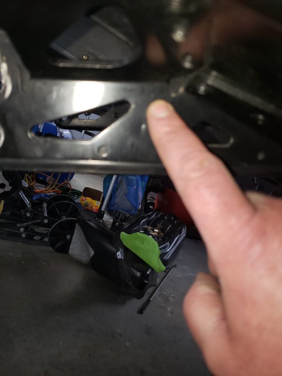

Just a quick ? When you took off your tank, do you have any spots where the tank is rubbing on the tunnel? I have one spot where is rubbed pretty bad, right side just behind where the rubber pads are on those raised parts on the tunnel.

Yes I just checked !! The other side has heat tape !Right on..
Good eye! I'll make sure to add a peice of heat tape or rubber

Mine is exactly like yours, more worn on the right.

I’ll have check mine when I install the seat heater and front shocks.
