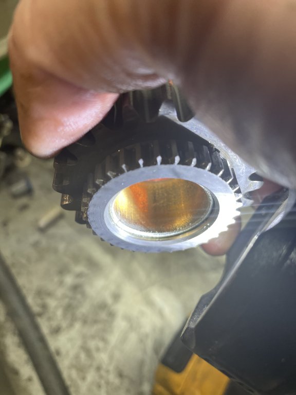

Started to tear into the sled last night. The top gear bushing looks a lot better than I was expecting for 7500ish miles. I wasn’t expecting there to be any of the coating left on the inside. I’ve always ran the chain on the loose side, about an extra 1/4 turn out. Gonna remove and inspect the drive axle tonight

The chain should 1.5 turns out! You're lucky you didn't have a failure in the case. This was a hot topic for quite a while, until it got worked out. Check in the FAQs.Started to tear into the sled last night. The top gear bushing looks a lot better than I was expecting for 7500ish miles. I wasn’t expecting there to be any of the coating left on the inside. I’ve always ran the chain on the loose side, about an extra 1/4 turn out. Gonna remove and inspect the drive axle tonight
- 5,617
- 4,238
That bushing doesn't look very good to me. The only reason there is a 'ring' of teflon left in that area is because it is supported by the female gear.Started to tear into the sled last night. The top gear bushing looks a lot better than I was expecting for 7500ish miles. I wasn’t expecting there to be any of the coating left on the inside. I’ve always ran the chain on the loose side, about an extra 1/4 turn out. Gonna remove and inspect the drive axle tonight

74Nytro, I agree. Chain too tight. Lucky you caught it when you did Yama4stroke!
Yes you dodged a bullet. Any more wear and shaft would be ruined best case!
