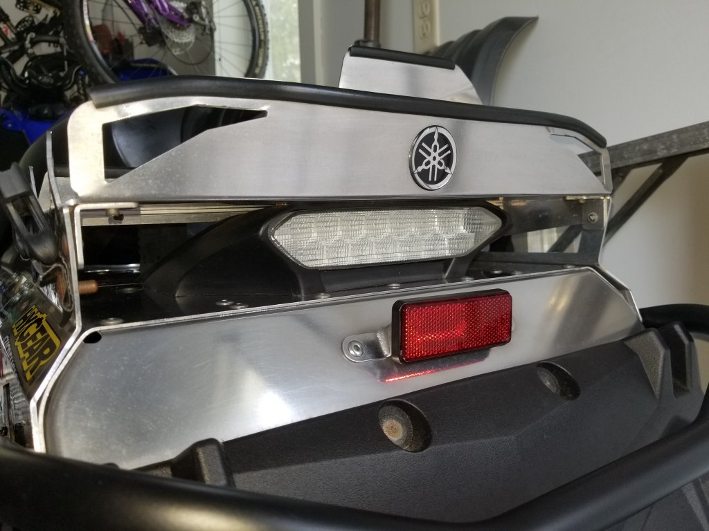

I just ordered two tubes of 1824, found them on the Autosol site www.autosol.com.  Amazon did not have 1824 and less than $10@, shipping and handling was $12.  Will post some before and after pics.

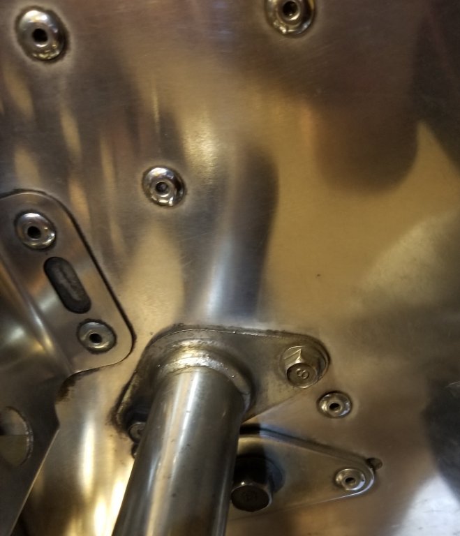

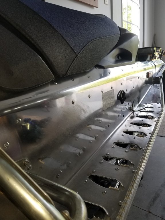

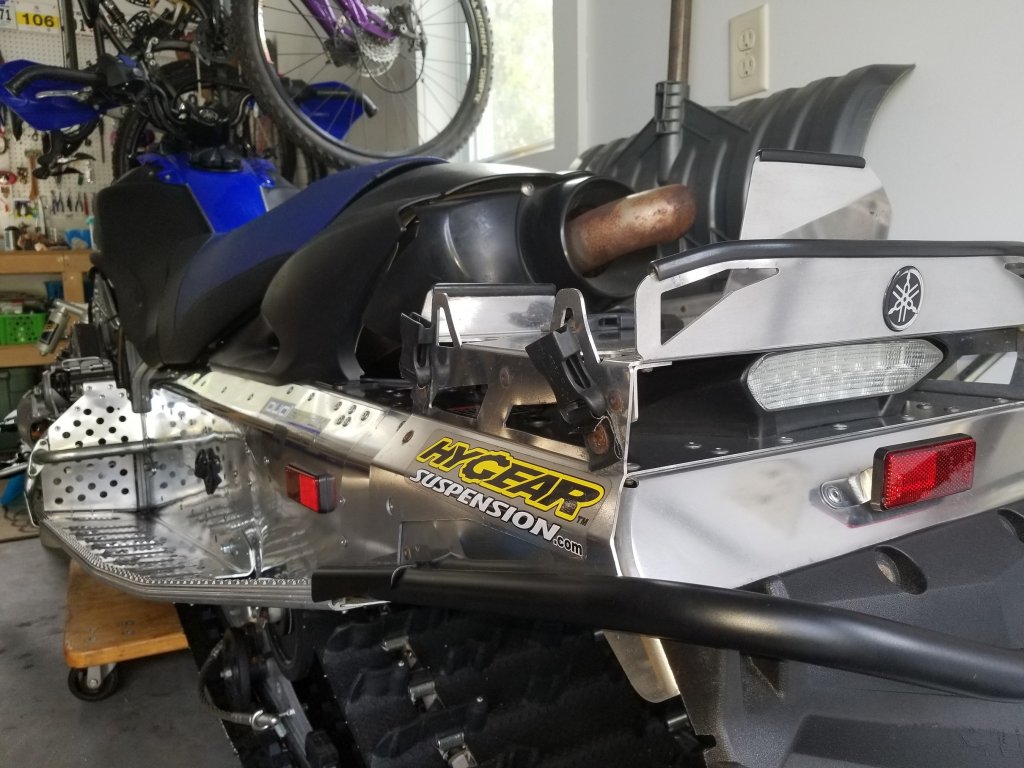

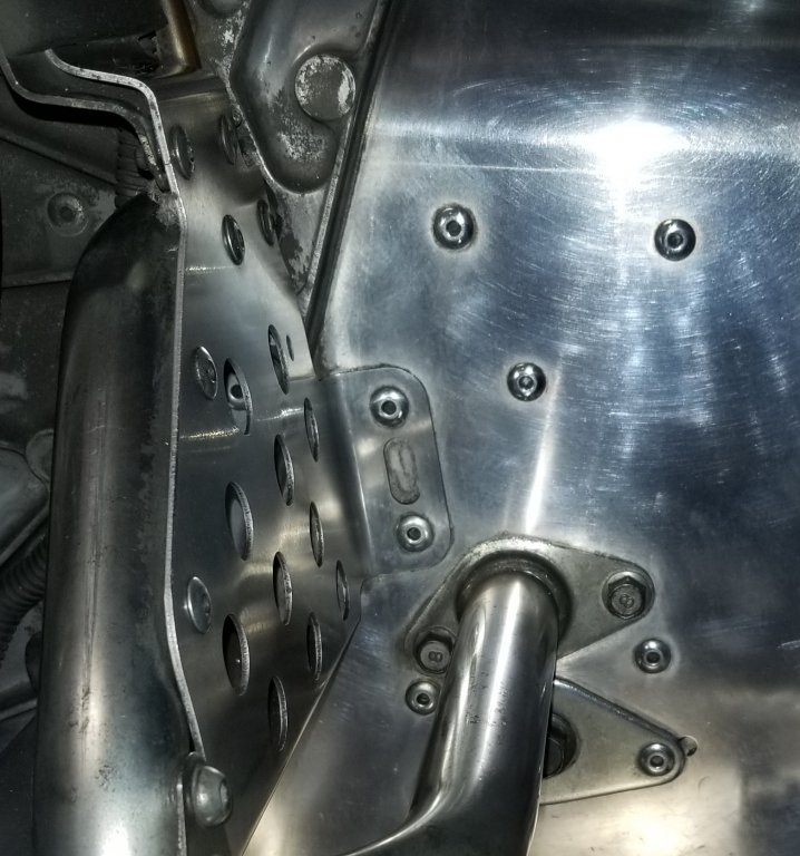

My Autosol 1824 aluminum polish arrived, stuff is magic.  Still takes some elbow grease and considering a power buffer to see if I can minimize the boot and saddle bag scratches.  Some of the tunnels posted here are mint, not a scratch on them... I have some wear and tear but that's ok, still looks night and day better... first coat of oxidation off left and back of sled.

Not much you can do with the saddle bag gouges short of sanding out the tunnel to minimize them but then the tunnel is wekened, but the boot scuffs can be massaged almost away with a black ebony compound followed by a very fine white aluminum compound. Look into Caswell Plating if you want to take it to that level. This is a link to a manual they publish to explain buffing and polishing and how to pick compounds and application wheels. The compound bars will last a LONG time with as little polishing as your going to do, just get larges.My Autosol 1824 aluminum polish arrived, stuff is magic. Still takes some elbow grease and considering a power buffer to see if I can minimize the boot and saddle bag scratches. Some of the tunnels posted here are mint, not a scratch on them... I have some wear and tear but that's ok, still looks night and day better... first coat of oxidation off left and back of sled.
View attachment 130275 View attachment 130276 View attachment 130277 View attachment 130278 View attachment 130279 View attachment 130280 View attachment 130281
