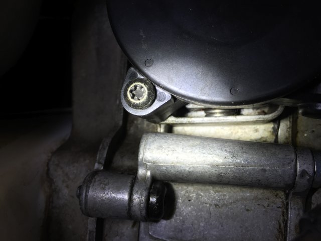

I agree if no issues leave it. You will quickly know whether you need it or not. The flash was not a recall so it's voluntary. The Reverse Detent is one update you should check for.
Can be seen without removing anything but side panel. Look for the spring and block under the reverse actuator.

So look to see if that spring is there?I agree if no issues leave it. You will quickly know whether you need it or not. The flash was not a recall so it's voluntary. The Reverse Detent is one update you should check for.
View attachment 120823 View attachment 120824
Yes. Would just be a hollow empty area there if not updated.So look to see if that spring is there?

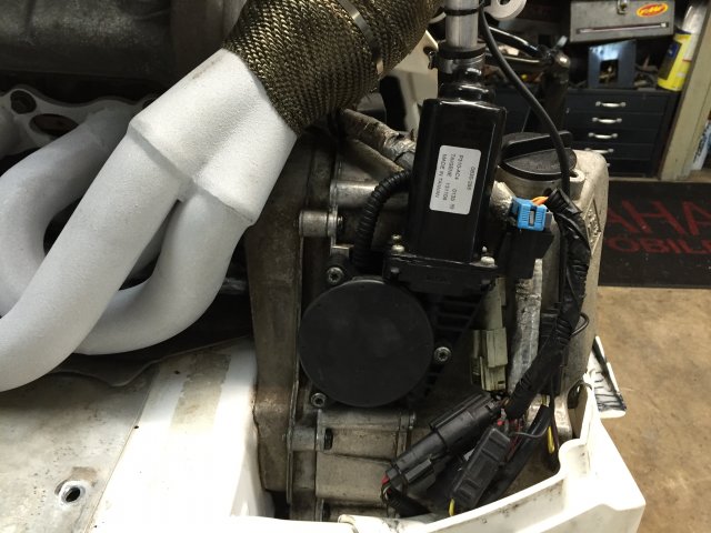

Cool! Looks like mine has been done. Thanks for the info. It's great have a group of people willing to help and share knowledge. Here is a pic of mine.Yes. Would just be a hollow empty area there if not updated.
