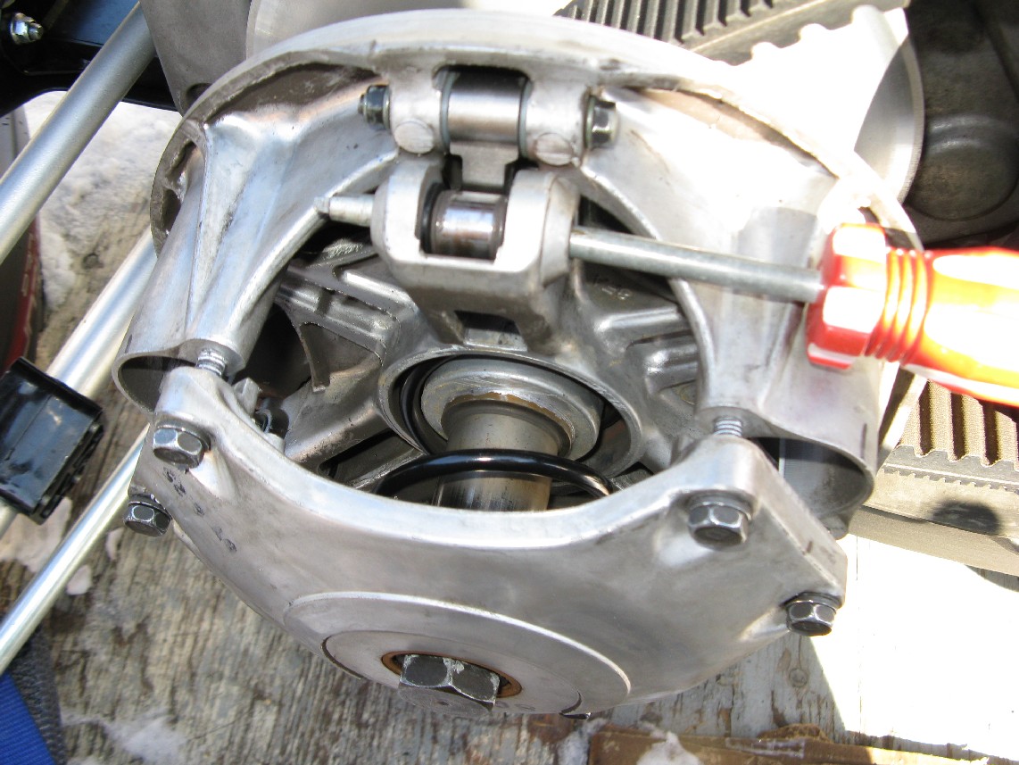

BombaPolaYama
Some pics of how I installed the rollers back in the primary clutch.
I found it difficult to reinstall the pin/bushing/whatever it is called while trying to hold the rollers and washers in place. So I put the roller and washers in place and put a screwdriver through the holes to hold it; then I was able to put the pin back in the other side while slowly pulling the screwdriver back. This way it was easier to keep everything lined up and was able to do the same when reinstalling the fly weights.
MikeWalters
- Feb 21, 2010
- 1,326
- 146
- 1,038
- Saskatchewan
- 2007 Phazer
Well my fingers aren't too fat so I found it easy. probably cause I am used to it from working on electronics.
But hey good tip
But hey good tip
