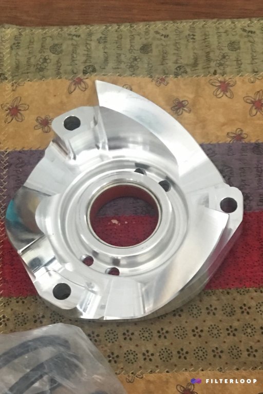

Well, checked back here a few times in the past 8-9 hours, no comments. Only one day off to getter done. Helix installed, reverse helix, bought from sidewinder forum on face book helix angle wasn't given. Dalton weights as I stated. Turbo Dynamic Powertrail tune, 270 horse with the turbo force muffler....went from 65 grams to 78 on the weights...129" studding this Summer. My pics of components won't load, sez their too big...ur making it more complicated not knowing the helix, what weights, what pipe do u have? what sled 129 137 141 153 - jeeez

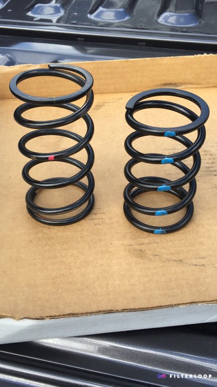

Helix and replaced taller spring with the black and blue spring in the primary....
waldo1
i like stock springs - dalton engage too high and 35 helix - maby 37 sometimes - dont like multi angle. which daltons do u have ?

Get in touch with Ben at Turbo Dynamics,he will fill you in on the clutching and gearing. What you described should be close to 275 hp from TD he likes stock 35 and maybe Dalton blk/org secondary wrapped to 70 degrees 6-1 and of course Dalton ramps come different base weight,see what it is stamped on side of ramp,and get a set of gram scales,and weigh base weight to see where it starts at empty,and add set screws from there. They are .7 1.5 2.0 and up,you can add 7 grams to whatever base weight you started at. Unless you have a set up from someone who has your set up,start light and add as you go. The blue/blk spring you have,i have run,its ok,but does have higher engagement than I like for tight trail riding,i like something with a 30-40 start and finish around 120-131 for shift on stock 35 helix.Well, checked back here a few times in the past 8-9 hours, no comments. Only one day off to getter done. Helix installed, reverse helix, bought from sidewinder forum on face book helix angle wasn't given. Dalton weights as I stated. Turbo Dynamic Powertrail tune, 270 horse with the turbo force muffler....went from 65 grams to 78 on the weights...129" studding this Summer. My pics of components won't load, sez their too big...

Nice bit of info there, thanks. This is my first new sled, truly a learning process....everything bought in the past was already done.Get in touch with Ben at Turbo Dynamics,he will fill you in on the clutching and gearing. What you described should be close to 275 hp from TD he likes stock 35 and maybe Dalton blk/org secondary wrapped to 70 degrees 6-1 and of course Dalton ramps come different base weight,see what it is stamped on side of ramp,and get a set of gram scales,and weigh base weight to see where it starts at empty,and add set screws from there. They are .7 1.5 2.0 and up,you can add 7 grams to whatever base weight you started at. Unless you have a set up from someone who has your set up,start light and add as you go. The blue/blk spring you have,i have run,its ok,but does have higher engagement than I like for tight trail riding,i like something with a 30-40 start and finish around 120-131 for shift on stock 35 helix.
