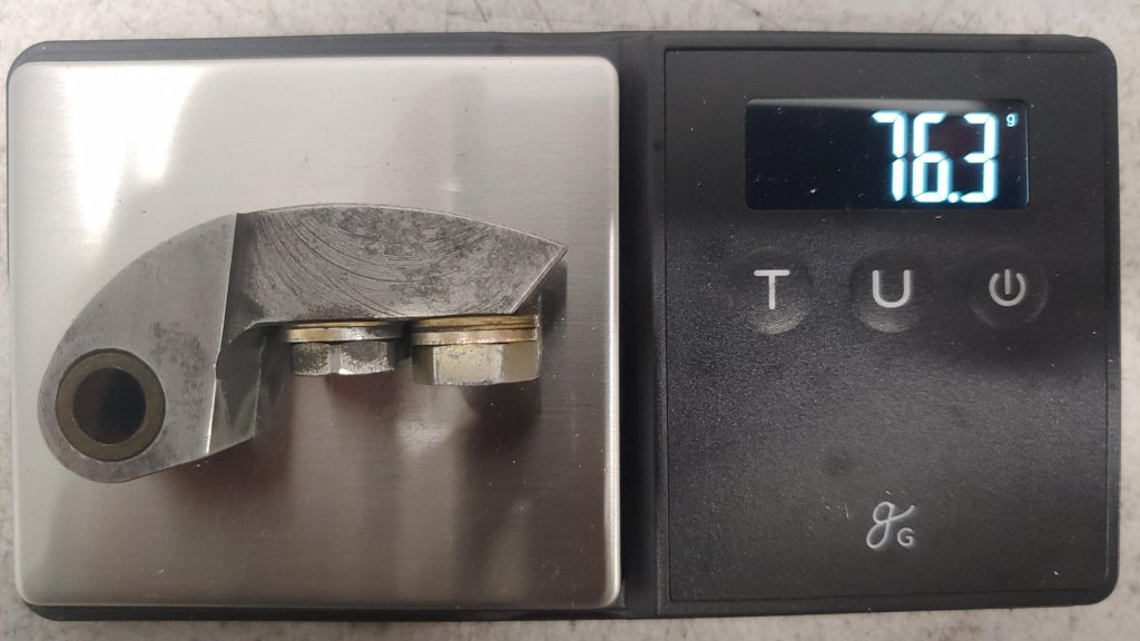

That 70 grams sounds right. I have been running HH for 10 years. And one gram in a HH is a lot of weight. More then guys think. On a straight 45 helix I pulled 68 grams and a straight 38 it pulls 69 grams. TD max 17 with 2.5 turbo force. And with above post running 70 on a 35 helix I would say is spot on. This is why I say 1 gram is a lot on these weights. The above weight on helixes puts it right in the 8900-9000 range up top. I also like to add that helix angles and total weight is not nearly much of a swing with HH WEIGHTS. Also the 3 roller secondary is more forgiving on helix angle increases pertaining to weight. .

I have a TD PowerTrail tune w/ CAI & 3" Super Quiet muffler. I am running a 12 Vector primary, TP Heavy Hitter weights, TP Orange primary spring, TP 14.8mm primary rollers, TP Orange secondary spring, Dalton 33/35 helix, and TP secondary rollers. I am right at 8900-9100 depending on conditions with the Heavy Hitter weights set to 76.3 grams (the Vector clutch requires heavier weights).
