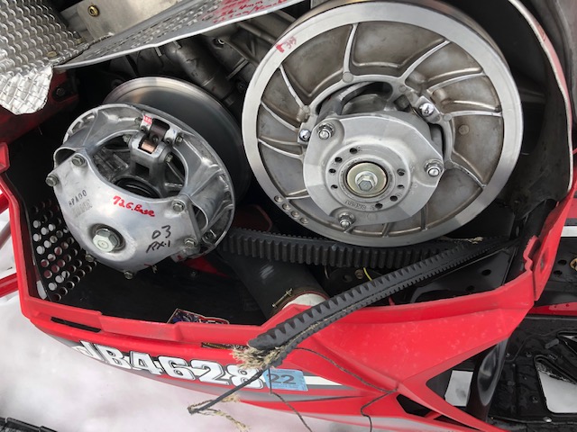

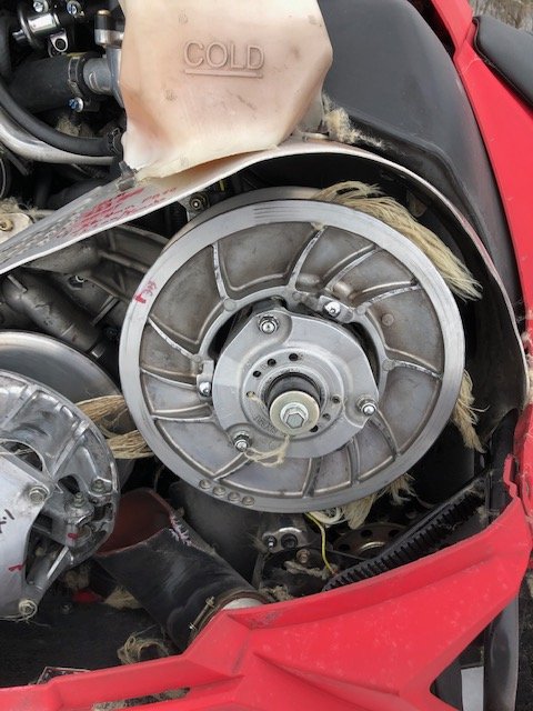

That is what I'm saying. I was at 95 degrees wrap today because I have my Helix's drilled with add 5* holes, on a V1 B/O with stock 35* helix and killed TWO XS belts upon switching to the 300 HP tune. It scaled at 165-303 and you could see the RPM climb pretty high at speeds starting up over 100 MPH on the logs as I look at them. For comparison, the SRX secondary I set at 80 with the new V2 on 35* is 217-372 on stock rollers. And I actually tested it this AM when the shop was cold at 218-402. That is some extreme side pressure and its just a V2 set at 80 on a 35 helix! I keep testing it because I can't believe its as high as it is. I remember when I switched to the Hi-Torque rollers in, I was forced to lighten up on the primary weight a bunch! They messed up my whole clutch package and I started to eat belts again after I thought I had an handle on belt blowing.
Its no wonder we are all over the board on these things! Without me testing on the drill press scale I'd never know how the secondary rollers affect the secondary side pressure! Throw the charts all out the window because they mean nothing with dealing with different rollers, torsion spring twist, etc.
The side pressure means everything to the belt and slippage vs. no slippage. It's why testing on a drill press scale accurately, means so much.
More helix, higher number = less secondary pressure.
Less spring wrap = less secondary pressure.
Easier to roll better rollers = less secondary pressure.
"Sticking", "binding rollers" like the stock Yamaha rollers in my drill press scale make for much higher scale numbers at the start, and even more so at the finish compared to the easy rolling Hi-Torque rollers. So Hi-Torque rollers need much stiffer springs and wraps to equal lighter springs as the stock Yamaha rollers do on the scale. I'm to the point of possibly going back to the sticky Yamaha rollers to apply more secondary pressure, or maybe going back to the heavy Cat springs, even on the XS 825. The XS does not show signs of slippage in the clutches like the 8JP or 8DN other than to just shine up the clutch faces. I have a new Gates Redline belt coming to try as well, we'll se how that one does.
I've done everything I can to lighten things up to make life easier on the primary rollers and make them last longer, but it might just be time to go back to a heavier secondary setup with more side force.
Two XS belts blown in less than 15 min today. I felt one was a freak thing, then the second went 10 min later. Its not pretty. The SAGA continues for the perfect balance and belt longevity. These two XS belts both have about 600 miles on them. And yes, they line up with the Hurricane bar perfectly, however I was allowing 1.5 mm of float which could also contribute to a mis-alignment. I find floating when under power to stick outward on hard acceleration, I may go back to locking the secondary down for no float again too.
