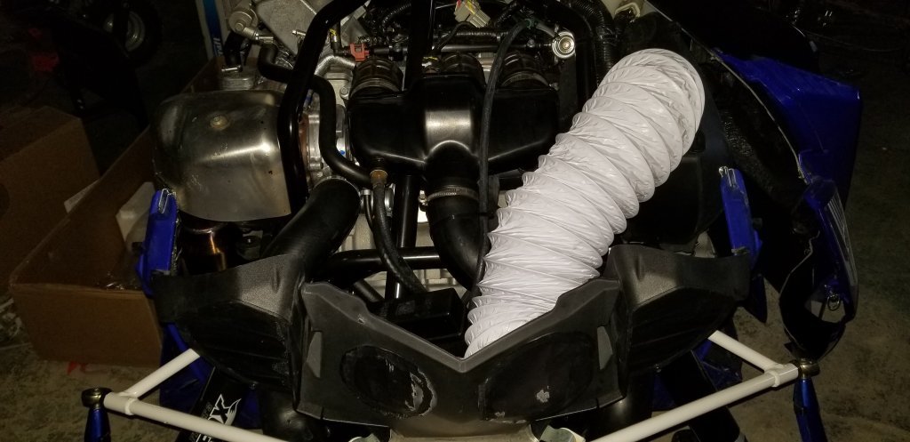

Here is a mod that i have done with good results. The temps on the mountain were -10c. The intake air temp on the dash was between 2c and -3c during the ride. I have an aftermarket light weight hood, but i think the same thing can be done by removing the lower intake case to gain some space. I used a 4" round soffit vent from the hardware store and a length of dryer vent to connect to the air intake box. A piece of frog skin over the vent to stop the snow from coming in is a critical thing that I didnt do initially. I also added a 3" vent to help with the under hood heat. No holes thru the hood and so far this is working great. Stock 2017 Mtn 162 no tune, 3" pipe.

Shouldn’t you be using the silver foil ducts, won’t the plastic one melt, just sayingEdit pic. make sure it's largest dimension is only 1080 pixels
