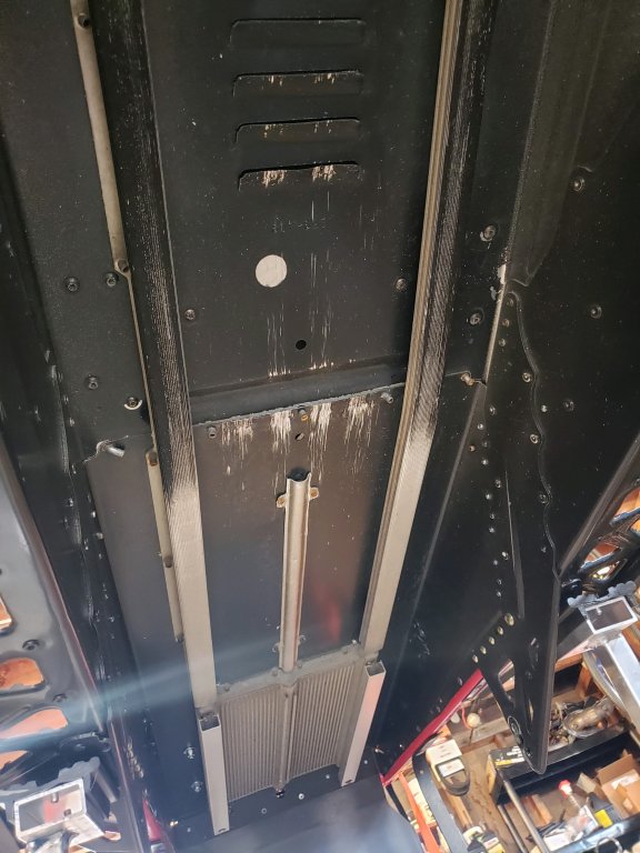

You running longer stud? I was looking at those STM protectors.. Pricey but I get it. And understand how they will truly protect..I am in the process of removing my BOP hose protectors and installing STM tunnel protectors since I am running studs.
If your going to stud better off to buy full length tunnel protectors.

Studs are 3/8" over lug on a 1.50 track.You running longer stud? I was looking at those STM protectors.. Pricey but I get it. And understand how they will truly protect..

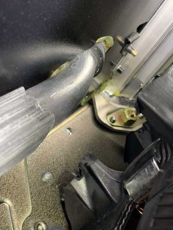

Just posting to help others out from my mistake of not putting the full length tunnel protectors in when studding. Track was run at 1/2" sag when adjusting just like in Precision EFI video.Picture is worth a 1000 words.

So the damage in the first pic was from the set-up in the second pic?

Yes. Track lugs had to have been folding over and center of track ballooning out.So the damage in the first pic was from the set-up in the second pic?
