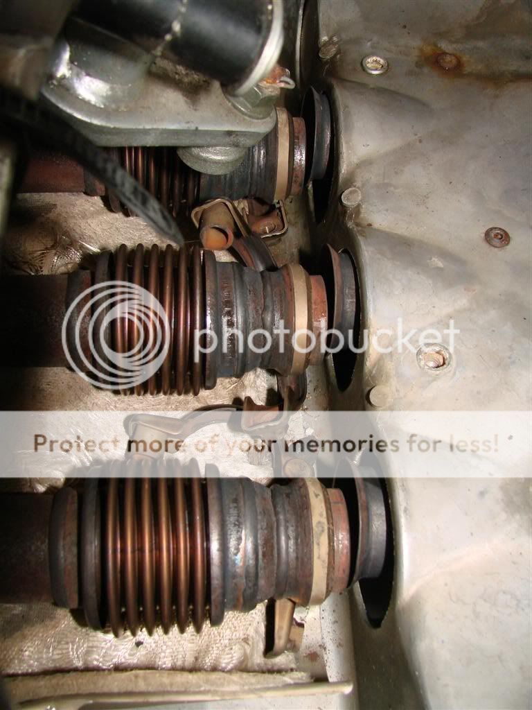

Alright...I've finally got my sled torn down again to check these out.
1200kms (I know...not a lot...but that's where I'm at). They seem to be working great. My clamps aren't turned and there doesn't seem to be any wear on anything.
Well, I pulled down the 06 Vector to have a look see. These donuts were installed without any Ultra Copper or other sealer and ran for around 2000 KM or 1200 Miles. When I plug the muffler, the sled idles down some but doesn't stall. I believe its the muffler gasket that is leaking in this case as no matter how tight I got that clamp, the muffler would move around like it was still loose. The other test mule, Nytro, will stall out if I plug its exhaust but it only has 250KM on it's gaskets.
I'm not sure what exactly happened but I could NOT get the donut off the flex pipe....tried channel locks (you can see some witness marks in the pics) and without ruining the gasket I decide to leave well enough alone. Only thing I can figure is that some carbon got under it and filled up any gaps or the donut actually shrunk due to heat cycling. At any rate, I think a cut off wheel and a steady hand would take them off no problem. All three clamps were still tight when I removed them (stock clamps, no grinding off the posts).
