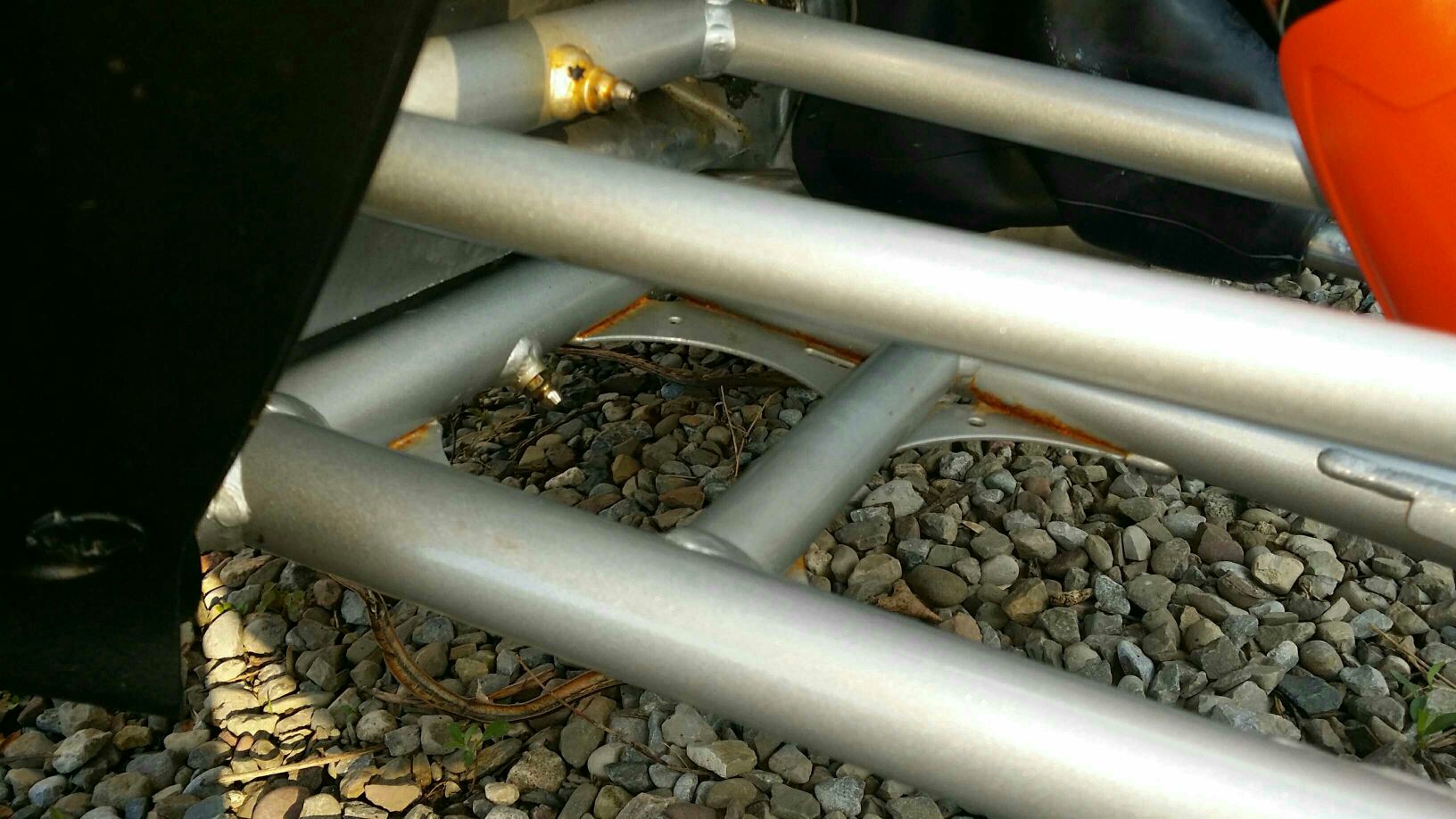

I can't believe with 588 Miles I am already having rust on the a arms. Just life? I guess doing the powder coat has to be.

Open trailer? I see stone in the pic too, like its stored over a stone "pad". Ideally you'd like a nice attached garage cement floor, then it goes down to a barn or storage cement floor, wood shed floor, a cement pad with a portable garage, cement pad no cover, stone pad, straight up dirt. Wash the sled, and wash it often, spray it down before storage with a protectant, like armor-all or a spray detailer, this will coat the surface in ions to repel moisture thereby slowing rusting and corrosion.
Clean off the rust stains with vinegar and try and mitigate the damage from returning. Powder coating will only buy you some time and cost you money, you have to attack the source to really end your issue.

Probably because those are areas that get less paint to protect the bare metal. You could try to clean it up and touch it up with a brush applied paint but would likely return. I had mine powder coated and have held up great. The powder is applied using static so it goes everywhere and then baked.

A little rust Sure is better than not starting or blown starter or the many other problems the kitty has had just my 2 cents.
The top a arm is aluminum on my attak.

I sandblasted mine and painted them with spray on bedliner. Looks good and very durable. Easy to touch up every year too.
Only did the bottom, the top ones weren't rusted.

Could you not just spray over the paint with the bedliner

Usually, bedliner is sprayed over paint. Just the rust that has to be removed.

Cool that's my plan then
