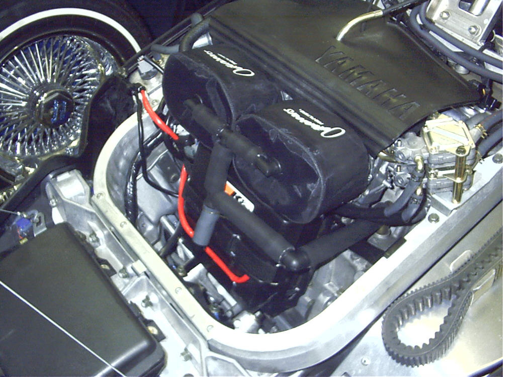

Thanks Cubby. You're the greatest.
Can I do smoething like this with a stock air box, or is it worth it?
Cheers,
Chris
Cheers,
Chris
Cubby's RX-1
- Nov 14, 2003
- 734
- 971
- Willoughby, Ohio
- www.cubbyscustoms.com
Ummmm, the (my) EVAC system was designed to be used with Freddies ECP filter kit. The first ECP filter kits were just vented into the outside air. Then Freddie & DYNAREX dynoed this EVAC set up & it improved the ECP filter kits performance. DYNAREX was the 1st to use this and he helped me make mine up (on this forum) so once I got it right, I posted pics & part #s for all the rest of youse to copy. If you are running a stock air box, you already have the factory EVAC system in place. The factory set-up goes from the crankcase to the black plastic thingy, then to your air box. The EVAC system is designed to relieve crankcase pressure by using the vacuum of the carbs to "suck out" crankcase pressure. Just like the top of the piston creates pressure, so does the underside. If you suck out some of that pressure the pistons will move better if they dont have to create that pressure. Well I think I got this right, feel free to correct me, coach Freddie.............Cubby

You are exactly right Cubby!
Freddie

Ok, now that you think I got all the answers (well, sometimes I do) maybe you can try this with your sled. Get the ECP filter kit. Like I said I dont know it all but I do know this thing works great on the RX-1. Then you could do my EVAC system to add even more power to your sled.......Cubby
