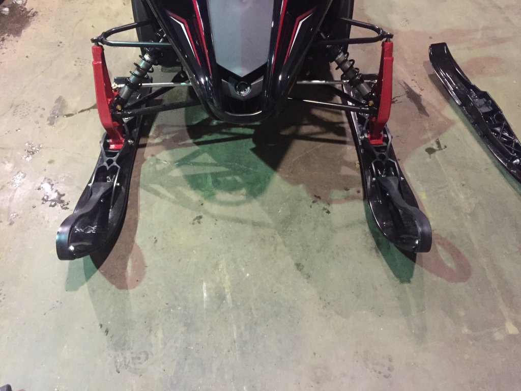

Sounds much like what I tried. Used a 4x4 on outside edge trying to get atleast one side of the hole to line up.
Best that I could do is about 1/8 - 1/4 hole on outside edge which causes the other side almost out.
I shall try again, but this time a second set of hands and shall try warming the rubber a bit. Yes tall side of rubber toward back of ski! If it still doesn't work I shall send a pic of the rubber and mounting kit part# to curve to make sure.

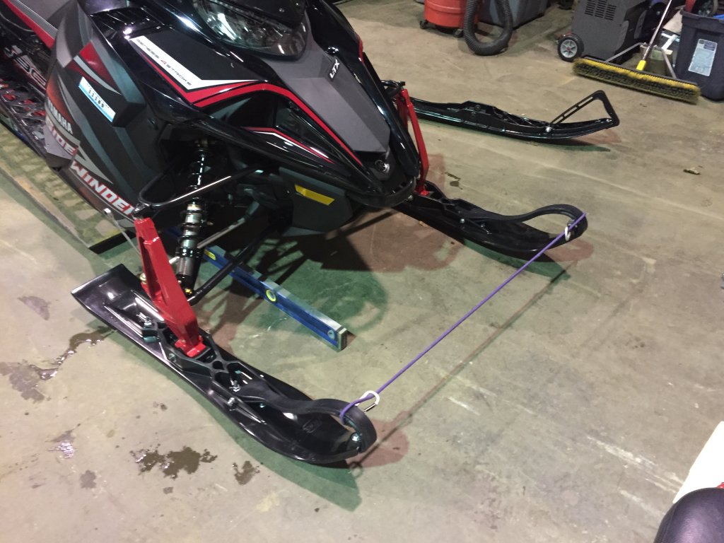

I put skis almost on edge to get bolt in on one side .......from outside in. Then put jack on inside edge to crank ski back straight...used a drift to pry hole in alignment and knocked bolt thru. I was a beech.

Thanks a bunch for your inspirationeallye, put the rubbers in hot water and let them soak and did as you said just one side of ski at a time!
Really tough time but yeah got it! Those rubbers are too thick and do not conform to bottom shape of spindle at all. Ends up pushing the center of rubber down about 1/4" .
Can't believe that plastic can take that pressure, almost enough to bend the bolt a bit!
Warm water, one side of ski at a time, some punches, hammer, straps and finally turn it through without thread damage... wow wow wow
