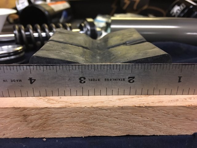

This is what I got for rubbers with their mount kit.

I bought Curve ski's about a month ago at the Novi snow show. My rubbers don't look like that. They're thicker on one side. Also, mine must have had the updated bushing because they fit perfectly. The only part on mine that was a loose fit was where the loop rolls back and fasten to the ski.

Those are definitely different than mine.

Yes I posted it above. It is not the one they have listed for 2015 and up Viper now. It is listed for arctic cat procross now.

Just got mine in the mail today. The Rubbers seem to be a different height front to back, I have not opened yet just by eye!

I talked to Cody at Curve Industries and they have updated the ski rubbers along with the bushings. Due to customer complaints about the difficulties mounting the skis and the skis tendency to dart on the Viper they made the needed changes. The new rubbers are thicker in the back to help raise the ski tips and designed to make installation easier. Also the bushings dimension are now corrected to properly fit the ski to the spindles.
They are sending out the correct mounting kit at no charge. How do you beat that for taking care of their customers. Again, another reason I stick with Curves.
