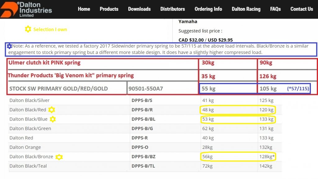

Im running a lesser primary spring now. Was running the Dalton 53/133kg....but now running the 48/120kg.

This is actually a very good question. The reason I say this is because every company makes a different profile. For example: The STM 60 YS weight that were developed for the Winder use a fairly flat curvature closer to stock. Does everyone use these? No. Many are using the 60Y's as they have a more round curvature similar to perhaps the heavy hitters. Does this equate to better belt life? Imho no. But you may see better ET's. So choose wisely if you're a trail rider that would like to come home on the same belt you left with.
Guys with the big tunes running the curved weights have such a violent upshift that the secondary is like wtf just happened. Its my opinion that we may need to slow down the shift somewhat with a flatter curve and maybe even a bigger primary spring. Remember we are always shifting with the primary clutch.
