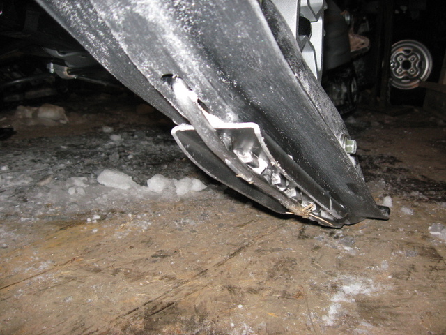

i have fixed my darting completly,looked at th snowtracker runners at my dealer,he let me take measurements of the channel over the carbide itself,so easy,i work on a brake press so i just took a pcs of 1/8 steel,bent it with 3/4 lips by 3'' wide 12'' long,drilled first 3 holes from the front , to match the bar,took bar off and put the channel first then the bar,you have to shim the bar so its about 1/4 lower than the channel,it works like a charm and didnt cost me a dime

Strange, my sled does the opposite, I can't get a ski to lift in a corner to save my life.
My front end just pushes, and doesn't want to turn...
I have new C&A's on the way, so that might help. Also, my stock carbides with 1500 miles on them are just about done, so that's not helping much...
Vector1 said:
My 08 RTX Phazer does not dart much at all, but my Nytro is so bad its dangerous. I tried turning the rubber around, but no good. Dooly's on it takes away the darting but than it pushes in the corners. I am going to order a set of the new Curve skis for the Nytro and will also try them on the Phazer to see what changes it makes.
Doolys only push if you don't get enough carbide........
Or if limiter strap is out.Tighten limiter and push will go away.
