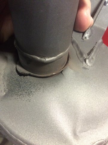

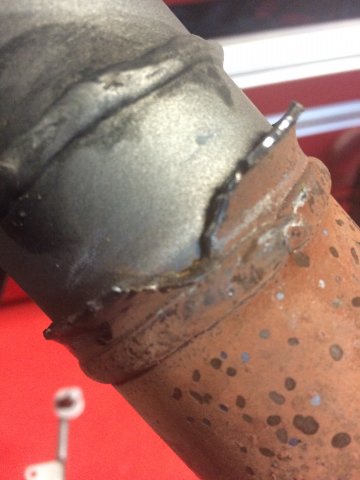

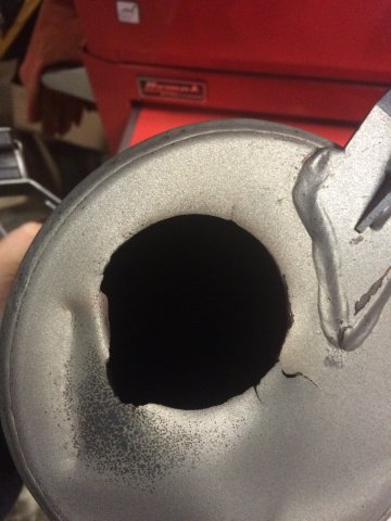

View attachment 104870 View attachment 104871 View attachment 104872 My can fell apart on me over the weekend. was cruising down the grade in Iron River MI going 55-60 and the bottom pipe fell out. Cracked all the way around right next to the weld. I found out what a straight piped Viper sounds like! WAH!!.. so I got home today and checked my buddies MBRP trail can. He has an Arctic Cat XF 7000 (same as Viper). His was also cracked half way around the bottom pipe. At least his didn't fall out to. This cant be a coincidence that 2 of them have the same exact issue. I would suggest that everyone that has one checks it out before they have the same issue as me. I will be calling MBRP Monday morning to see what they have to say about it.
Can looks bent, how does the tip look? By that I mean does the tip look like it hit anything?

My buddies and I had all 3 of our MBRP cans break yesterday within 50 miles of one another. 2 of them had the pipe fall completely out and 1 was cracked half way around. All 3 sled have between 425 and 500 miles on the cans. We called MBRP this morning and the problem is resolved, they are sending out 3 new cans today. GREAT customer service!! Thank you MBRP!!

We had the earlier version. New ones will be stainless. They said that we never should have gotten the cans that we did, which I took as a bad batch. New units also have gussets on the pipe which should eliminate this from happening again.

that's just the way the can comes bottom pipe isn't bent at all. I did not hit anything.Can looks bent, how does the tip look? By that I mean does the tip look like it hit anything?
