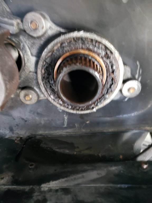

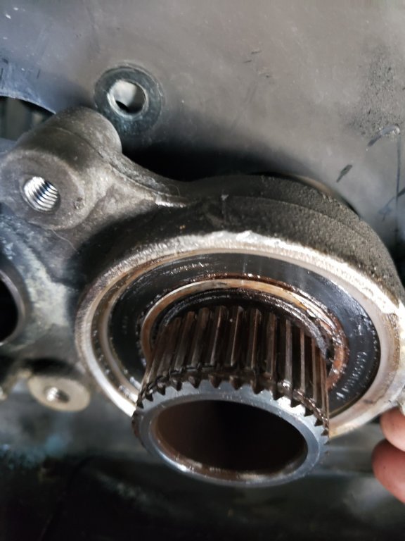

Going to replace the bearings since the seal isn't holding the greaseView attachment 154778 View attachment 154779
Managed to remove bearing it took lots of heat with a propane torch and a puller

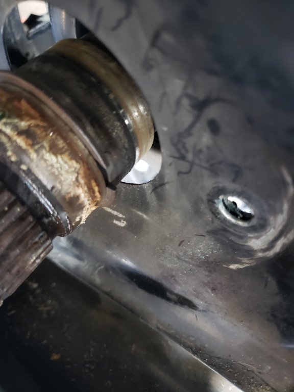

Here is the shaft with the loctite residue after heating it to removeManaged to remove bearing it took lots of heat with a propane torch and a pullerView attachment 154780

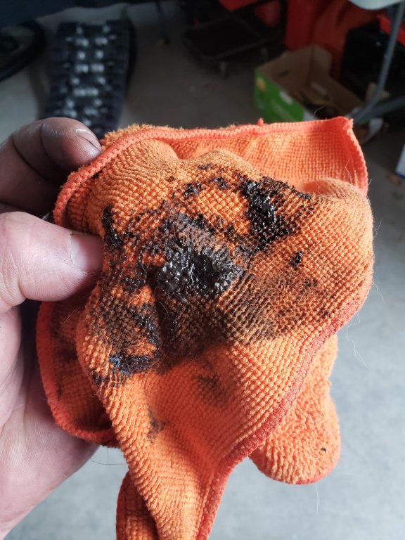

I actually never repacked the original bearing last season because there was no sign of leakage! This is the original grease gushing outMarc, my bearing does the same and spits out grease after re-packing. This is actually from over-packing. Look at a brand new bearing and see how little grease is really in there. I always add more than they do but don't pack it right full!
RAMSOMAIR
Wow, way more grease than China bearing usually has lol.

The picture is deceiving not much grease!Wow, way more grease than China bearing usually has lol.
