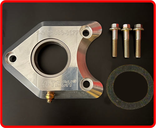

By the time I met Ron at the sled show and learned of the Hi Tech product my sled was already back together with the collared-set screw-bearing. It was too late.What is the point of installing this extended collar bearing on a new shaft? Seems like it would be better to just use the driveshaft saver or a driveshaft saver AND the Hi-Tech Track Shaft Durability Kit for the extra bearing & tunnel strength that it gives.
This product is not widely known and I have managed to introduce it to a few friends touting its virtue as likely the better solution - Which they purchased and installed.
If I had a time machine - it could have been different. lol.
Technically the collared bearing should work. But there is something about these procross chassis that have issue with flexing - or wanting to flex.
I applaud the guys that had their shaft machined to accept an interference fit with bearing pressed on. I am just a little eerie about having the shaft heated up by a weld for fear it weakens it. And in the future taking it off has all the hallmarks of being a disaster - even with a puller. If that thing is seized on it would be fun trying to yank it off (I can attest to this as years ago I tried green loctite which was lots of fun).
The final question is - if that side of the shaft is rigid with an interference fit and that chassis wants some forgiveness (flex); where does that force transfer - up to the rivets along the bulkhead - will they start tearing there or somewhere else????
