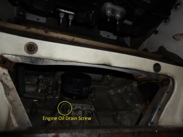

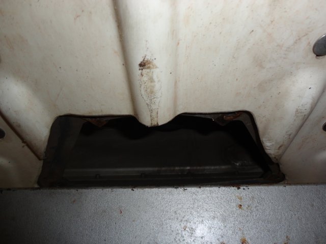

Thanks brother,now it looks simple like you and many others already stated,sometimes I just have to see the whole thing to get my old mind around some things lol, I noticed you are running doubles backers like I have in the past,and most likely will on this one,are those the 11/2" tall nuts or the extra tall 3/4" and what studs and backers are those,they don't look like woddy's,I have seen some good pricing on Max exstreem studs and backers,i wanted something in the 1.400 range so I decided to go with woody megabites 1.450 144 all on doubles,two plates one row one plate next row,but alternate the standalone double plate from side to side,on each single.Here you go. I have a accessory skid plate which I modded to make getting to access plate easy. Still same 4 screws.
When you look up into the hole created by panel removal this is what you see.
Dont get any easier than that. MNM Snowbeast this is for you!
