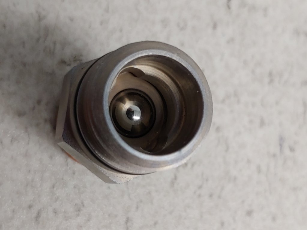

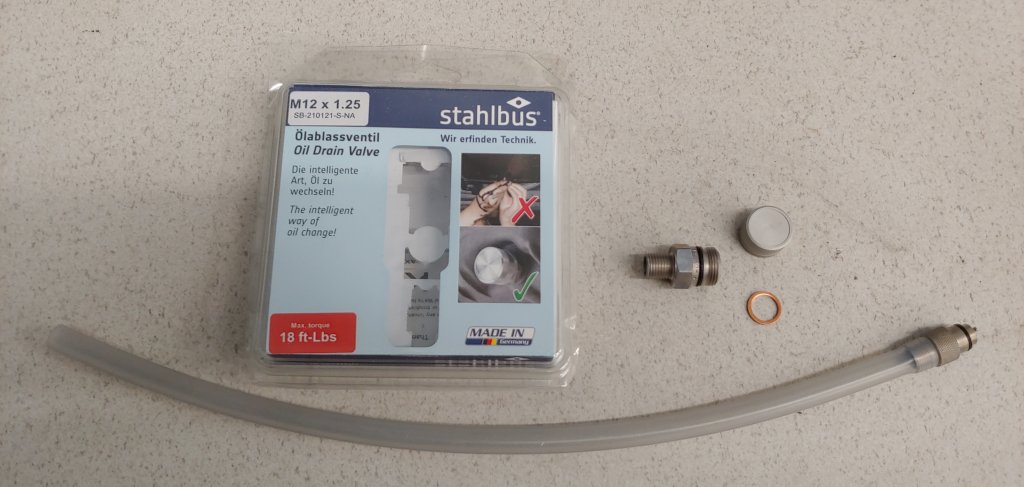

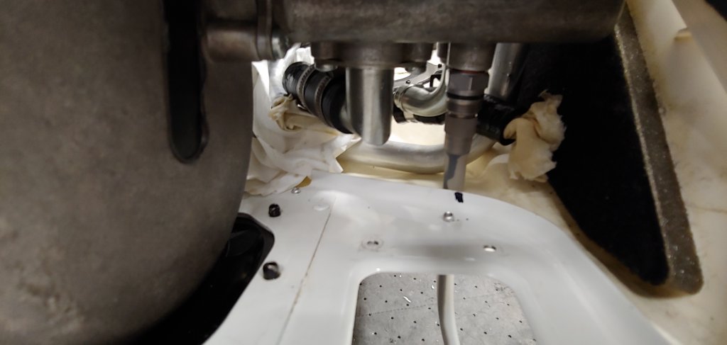

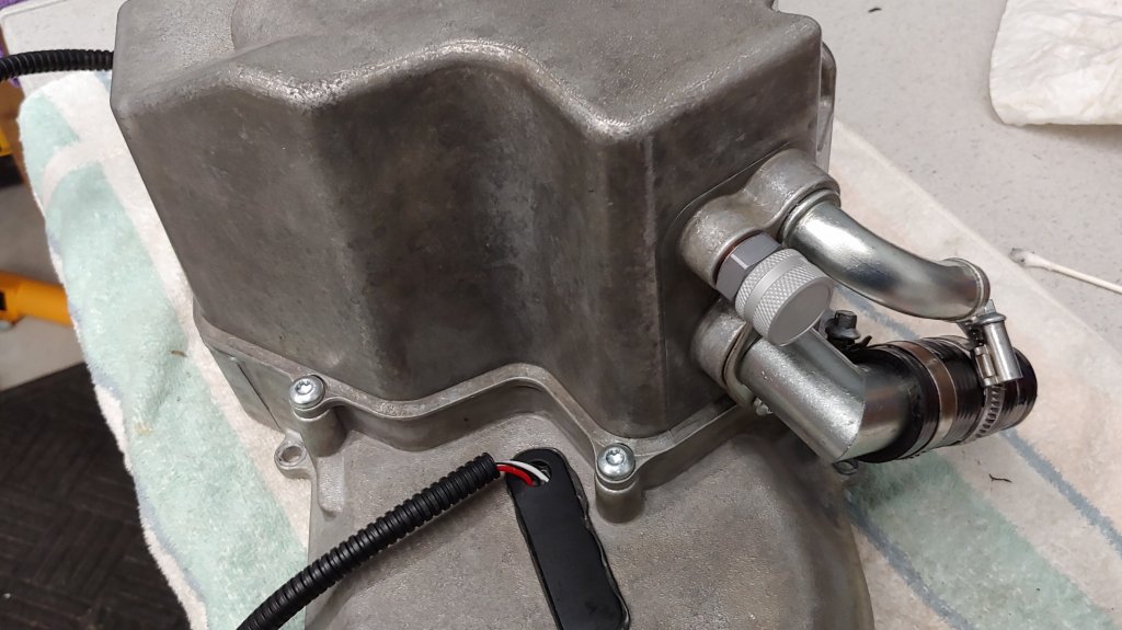

After one time of making a mess draining the oil, I decided there has to be a better way. I installed a Stahlbus M12x1.25 drain valve and drilled a 3/4" hole in the belly pan just in front of the lower foot well plate to pass the drain tube up through. The Stahlbus drain valve is very well made (German) and is around $45. There is a ball check in the oil pan fitting and a cap with O-ring on the body for sealing. When you want to drain the oil, you simply remove the cap, pass the tube up through the 3/4 hole in the belly pan, push it in the fitting and lock it in with 1/4 turn. This depresses the ball to allow the oil to flow out. It is best to drain with warm oil.
I also updated the chaincase O-ring to the newer silicone one and I am installing flanged socket head cap screws for the chaincase cover bolts for easier access using a ball end hex driver.
