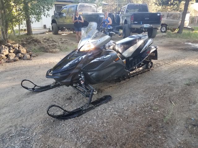

And long awaited.... here's the $200 project finished!
