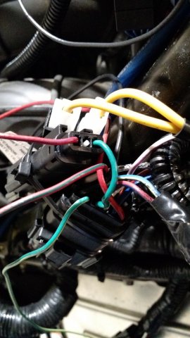

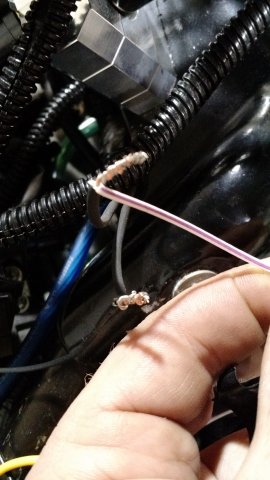

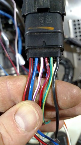

Here is a collection of images showing all the connections. The only one not showing is the tail light that connects up by the brake as that was connection remains from the origanal harness.
Grn/ Yel is currently hooked up to RPS
Red/Vlt to Red/Grn
Cat Tether Switch installed
Red/Blk and Blk(ground) to Hand/Thumb warmers
Blue, Wh, Red/Org are taped off since I won't be using the headlight
Black jumper (ground) and Whi/Vlt to reverse
Red/Vlt to Red/Grn

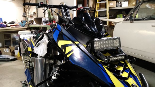

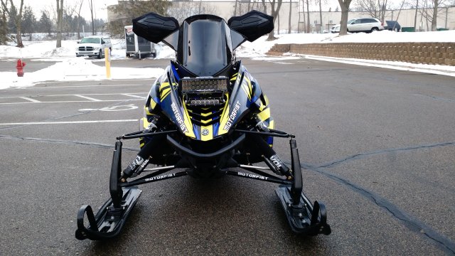

On the "bright" side.... Should be pretty sweet when all done!
On the "bright" side.... Should be pretty sweet when all done!View attachment 103425
Looks like in the off season you can rent that thing out as a tanning bed!!!!!!

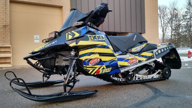

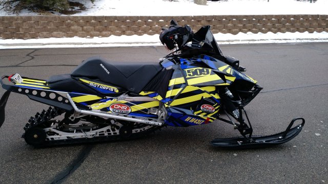

Well she's finally done! Well, mostly..always a work in progress of course. Still need to install blue ski loops.
Anyway, electrical gremlins ironed out.. Actually, I was just being a dumb #*$&@ and had the bar harness plugged into the guage harness (they both fit each other) and after that it was just a matter of soldering and routing loom.
Anyway I think it turned out well and I'll report back on how the light bar works after next weekend.
Big thanks to everyone who helped me!
