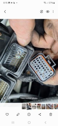

Have a 2018 here. Came in because won't shift into reverse and has an intermittent electrical misfire.
Found out it has corrosion at ECU plug. I suspect this is something that rarely occurs, but thought I'd share. The active error code was P1689.

Was this sled trailered on an open trailer?Have a 2018 here. Came in because won't shift into reverse and has an intermittent electrical misfire.

This sled is new to me, but I'd say at some point it was.Was this sled trailered on an open trailer?
However, I've seen much worse as far as salt damage.
