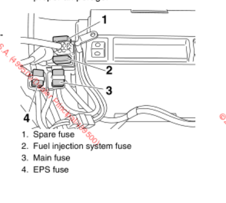

Question is on my 2014 Vector LTX. If you look at the picture, you see the green and the pink'ish fuse. One is a 30A and the other is a 40A. Don't remember which is which and I'm too lazy and tires to go downstairs and look.
The picture was taken from the (sitting on the sled) left side of the sled.
I took the two fuses off to put more dielectric grease on them but I forgot to take a picture before I took them apart. Now I don't know if I have the fuses on the correct side.
Mr. Sled sent me the shop manual for the sled (thank you Sir!) but I couldn't make out which one goes where.
Can anybody help?
Main fuse is 40 amp and EPS is 30 amp. The main fuse is toward the battery
