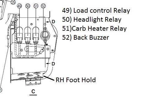

Can you tell me where the LC relay is?
Is it near one of the footrests?
It's behind the RH foot hold plastic vent.

Thanks Grizz. Local Yami dealer has one in stock....$20. I'm very optimistic that this will take care of the issue.

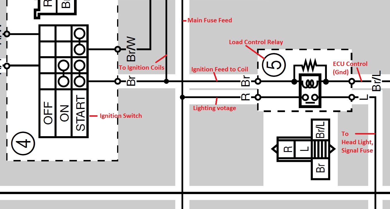

One other thing to consider would be corroded contacts in the ignition switch and due to cycling the switch back after stalling you made contact again this may be something to consider if the relay doesnt solve your problem I have a honda street bike that had a similar problem this summer
No, The ignition feed powers to the coils and load control relay through the same contacts. The engine runs but there are no lights which are powered through the relay so the ignition is fine. If all the wires and connectors are OK then it's most likely the relay. If the lights don't come on again the problem can be diagnosed by taking a couple of voltage readings at the relay. There should be 12-14 volts feeding the relay coil when the ignition is turned on and a grounded control signal from the ECU when the engine is running. If those are present then measure the output voltage to the head light and sig fuses (check these at the fuse box)
