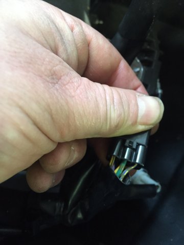

Just checked connection looks good no corrosion at all , frustrating problem thx for all the help.

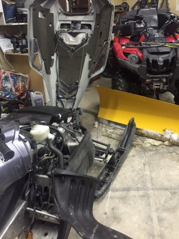

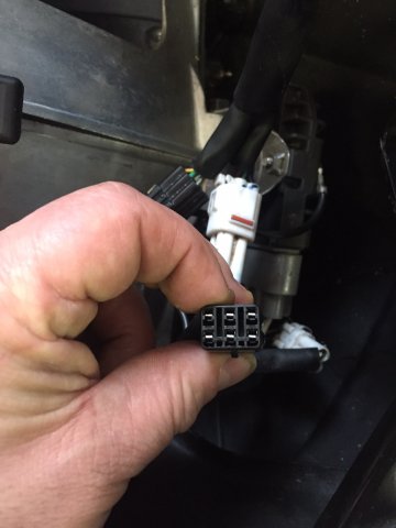

Ground wire looks good , I pulled connector that feeds the dash since I have no power at dash except the high beam light that will come light up , only the green wire has power is this the only wire that should have power ? If there is another power wire then I will follow that wire as it must be the problem wire . Thx for the all the help as weather is awesome and would love to get to lake but need sled.

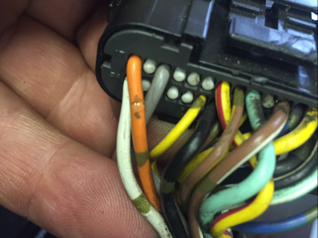

I have no power at the blue /red wire at fuse box , got power on all other wires at fuse box , the orange wire can't see how it got skinned a little nothing close to rub , thx again for help

Just looked up the parts diagram and the connector I found the skinned wire on go to what Yamaha calls ignitor unit assy , thx again for the help
