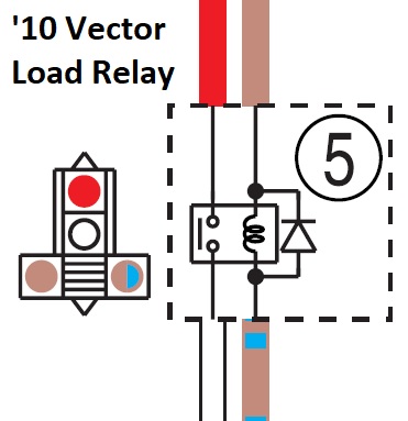

I know this thread is old, but which one is the load control relay exactly? I see the relays are on the right side between the footwell and reverse lever. I just picked up a 2010 Vector GT for the lady, and that relay is starting to stick on start-up.

Wire color code

Grizz, do you know if this is similar to the rage gt?just above the right toe hold and below the reverse lever. Remove vented plastic panel.
