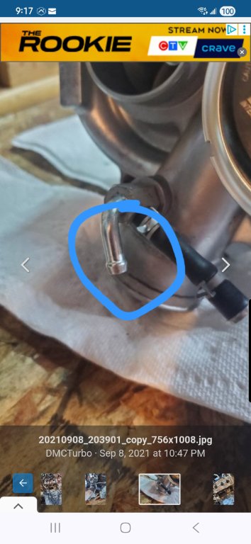

Drill out the restrictor in this.

Is restriction right at the end where hose barb is? Drill it out to what size?Drill out the restrictor in this.

Its been a while. Pretty sure its right at the end. You can see the restrictor inside. You need to drill it to the size it is before the restrictor. Don't recall the exact drill bit size.Is restriction right at the end where hose barb is? Drill it out to what size?
Dereck I thought the oil restrictor needed to be drilled out on the banjo bolt, but Maybe that is only necessary on the Turbo Technics kit?

I don't remember doing that on either kit to be honest.Dereck I thought the oil restrictor needed to be drilled out on the banjo bolt, but Maybe that is only necessary on the Turbo Technics kit?

The "restriction" on the stock turbo is not banjo bolts. The "restriction" is down in turbo housing just before center bearing (machined in by IHI, or whoever is machining the housing). Does no good to drill out banjo bolts. The 998 has plenty of oil pressure. From my experience, no additional oil is needed (on stock turbo). Don't know anything about Turbo Technics kit.Dereck I thought the oil restrictor needed to be drilled out on the banjo bolt, but Maybe that is only necessary on the Turbo Technics kit?
The Turbo Technics turbo is a turbo upgrade offered by Hurricane. Oil supply is insufficient for that turbo with the OEM set up.The "restriction" on the stock turbo is not banjo bolts. The "restriction" is down in turbo housing just before center bearing (machined in by IHI, or whoever is machining the housing). Does no good to drill out banjo bolts. The 998 has plenty of oil pressure. From my experience, no additional oil is needed (on stock turbo). Don't know anything about Turbo Technics kit.
From their web site:
"The Hurricane Turbo Tech Kit is exchanged with your stock turbo. The stock turbine housing is machined to fit the new Hurricane Turbo Tech cartridge and compressor. "
"It is also necessary to modify the stock oil inlet banjo bolt by drilling the hole to 3.5mm to allow the necessary oil flow required into the turbo. The stock oil hose from the engine to turbo is reused with the modified banjo bolt."
