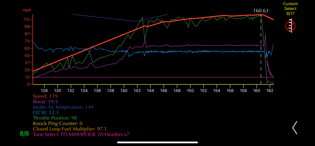

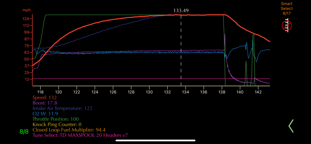

The faster pass is obviously on better ice conditions, but boost is low at 17.8 pounds. The second log is the pass just before I blew the belt. This motor held around 22 pounds, if I remember correctly, last time I checked it

Also, not sure why the throttle position is so choppy on the logs sometime?
Looks to me like you have a TPS issue as it should not give an erratic readout once its held wide open...100% should be 100% so as not to send confusing info to the ECU.

Agreed, but the rpm doesn't fluctuate while riding it and the boost is always steady on the gauge. Makes me wonder if its a communication issue or actually a TPS issueLooks to me like you have a TPS issue as it should not give an erratic readout once its held wide open...100% should be 100% so as not to send confusing info to the ECU.

You see a boost spike after every throttle glitch and a small drop in speed after the big one at 143. This seems like its a real issue with the TPS and is likely keeping you from building boost.

On the log with low boost, the throttle reading is steady? Right now it shows boost is 17.9-18.1psi, which is exactly where it starts leaking on my boost leak tester.You see a boost spike after every throttle glitch and a small drop in speed after the big one at 143. This seems like its a real issue with the TPS and is likely keeping you from building boost.

Oh.. you are right.. hmm.. The TPS thing seems to be real at least that there is a correlation between what the sled thinks is happening and what is happening to boost. Can you switch the scale on the left so it is boost instead of mph?
