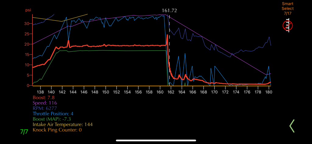

You’re right, earthling. Anytime the throttle dips, the boost spikes.Oh.. you are right.. hmm.. The TPS thing seems to be real at least that there is a correlation between what the sled thinks is happening and what is happening to boost. Can you switch the scale on the left so it is boost instead of mph?

I think that may be normal. You just closed the throttle valves and the system needs a small amount of time to react.You’re right, earthling. Anytime the throttle dips, the boost spikes.

The boost spikes I guess are normal but it means that the ECU really thinks that the throttle is not solid at 100%. Changing the scale just makes it more visible. No idea however why the map without the throttle dips has the boost running lower... unless. If you go back to the map that has the high boost, I wonder if the throttle dropping out is causing boost spikes giving you a false boost reading?? Changing the scale on that log to PSI on the left will magnify what is happening to boost pressure throughout the run.
