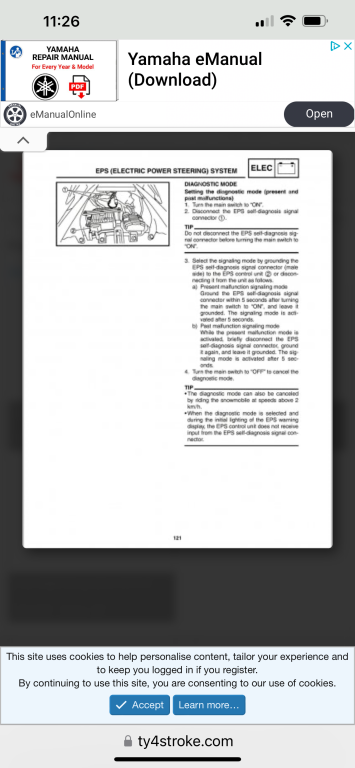

I’ve searched through the forums for this and didn’t find anything to resolve my issue so starting a new post.
I have a 2011 Apex SE. had it for 3 years and I don’t think the eps ever worked on it. The light did come on a couple of times when it was really cold when I first got it but nothing since other than coming on for a few seconds when I start it.
I checked all the wiring and fuse and everything looks good. Today I tried to get it into diagnostic mode a few times by turning the key on and then grounding out the wire on the unit but the EPS light stays solid on the cluster. Any advice/thoughts appreciated. Thank you

Are you sure this is the proper procedure for diagnostic mode. I don't have your model but this sounds a little off to me. Like the others I think that what you report with the EPS light indicates all normal.Today I tried to get it into diagnostic mode a few times by turning the key on and then grounding out the wire on the unit but the EPS light stays solid on the cluster. Any advice/thoughts appreciated. Thank you

Maybe this thread will help, it's my experience and how I fixed it

Thanks, I had seen that. Wires all good on mine. In any case I will leave well enough alone. I started it up yesterday while the skis were on dollies and it’s evident the eps is working when I turn the bars (compared to when it’s not running).
