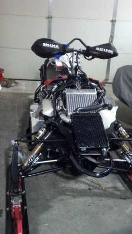

Update: Note to all with the Float Evols (RTX LE models) be sure to check orientation of the Evol chamber. It should NOT be offset to the rear near the tie rods.
The Evol chamber on the RC shocks is offset to the one side of center. On one machine pictured they offset rearward. On another they offset forward. So which one is it?

You have to orient them to the front or they will hit the steering linkage rods on compression. I know there is now instructions for them but I put mine in then let all the air out and they made contact. Had to switch them. I looked and that picture appears to be on wrong.
Thanks. I looked at it again and see what you found.
The Evol RC shocks have a piggyback oil/piston reservoir up top and an Evol air chamber at the bottom.
FYI based on the pics from Kerrdog his Evol chambers are to the rear. I went back into my pics and they came oriented forward.
Mine are to the front. Like Yamadogs. Also Evols on bottom. There is only enough of the float fluid which is thicker than gear oil to provide lube. A tablespoon at most. In the newest Fox Evols there is nothing in either chamber other than lube on seals. Put the Evol chamber down and to the front.

Yeah mine were on wrong the dealer told me to look and see if they touched the steering rod and they did,swapped em and now it's good to go
Even the pros put em on backwards, now I don't feel so bad.

Lol yeah it wouldn't be hard to do that's for sure,mine was one of the first RTX LE's to be shipped and someone forgot to put assembly instructions in with it,but we caught it before I rode it so no big deal
Dealer puts the shocks on. This explains the inconsistency.

Yes and mine was the only RTX LE they ordered,I personaly fault cat for not sending assembly instructions,these guys are really good mechanics and they've never seen these shocks before let alone put them on a sled so no harm no foul,it would do some damage though if it was ridden that wayDealer puts the shocks on. This explains the inconsistency.
