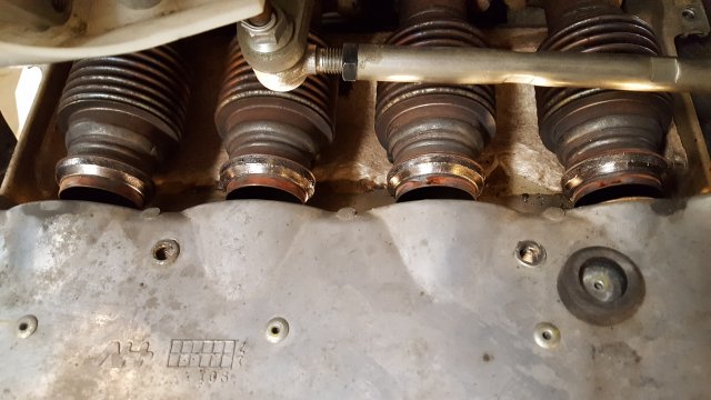

I will also say that changing my factory exhaust donuts at 6000 miles was a waste of time, as they looked brand new. I already had the copper, so they went in anyways.
Northern: I found the same thing on my 2011 Apex, the stock donuts seem to be made with a wire mesh embedded inside of them that holds up far better than previous versions on 06-10. I did find that one or two were starting to de-laminate away from the wire mesh, so I replaced with copper. The wire mesh had actually sunk a hatch/knurled pattern inside the flare of the titanium exup pipe, likely due to the kind of heat this joint sees. I buffed the knurled deformation off before installing the copper donuts.
The valve inside the exup chamber can come out simply by removing it from the side with the mounting screws if that is the way you plan to go next time. No need to remove from sled. I too experimented with valve out, and fabricated a 1/4"thick stainless steel close off plate to bolt over the opening using the stock gasket.
Oddly enough, my exup cables had never broke in 19,000kms, and it was one of the first 11's shipped into Canada.
Correct!! Big waste of time until the flanges crack on it.. happened at about 12000 miles.
