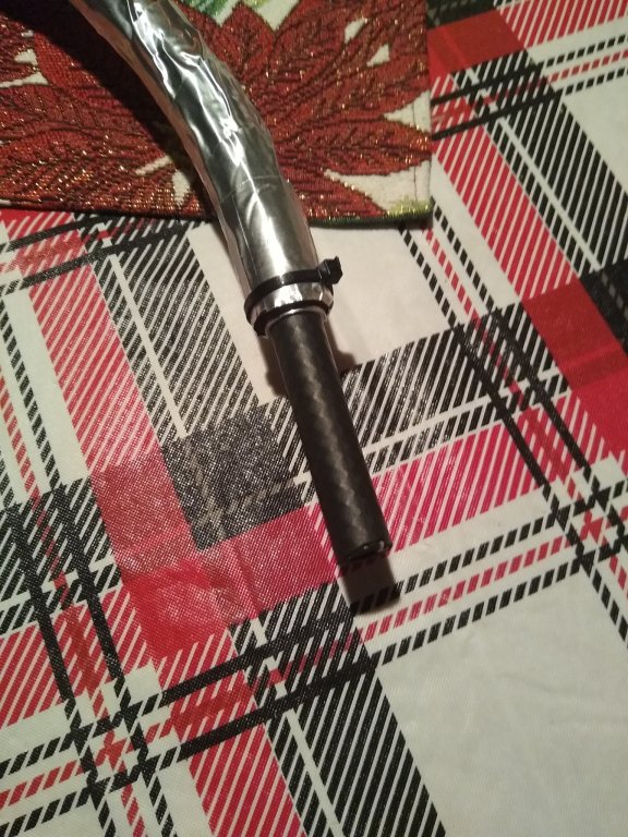

Great to hear!I got the hose & tape warm & used mild detergent to clean rubber off. I kinda formed hose to it's new natural state as I applied tape. It seems as thou it sticks to itself better than the rubber. All in all, it looks good.Buy the wrap with adhesive backing - clean rubber w lacquer thinner/acetone/brake clean. Stays on very well for years.

Hey Mike, do you have any problems with that tape around hose, coming off?
The reason I ask is I have an interior headliner spray, that once applied it will never come off. Super tacky....
That hose held up well actually, but has since been replaced by some black 5/8" fuel hose. The end of that clear braided reinforced hose was getting pretty crispy on the end from the heat of the exhaust from the muffler.
I use no heat tape at all on the new 5/8" black fuel line and it performs just fine.

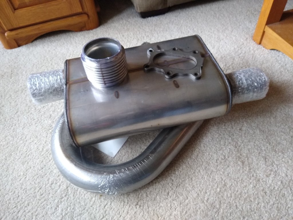

Parts and labor $600. that includes 1800° heat wrap & Aluminum shield ($150) As long as fabricator hits the mark for allotted time.1/4 of the price of the "order button"
Wish I could find a factory shield, it is what it is.

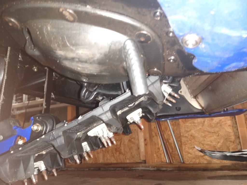

So, I was able to find an aluminum reducer (ROV delete) and slip the end thru the hole next the chaincase.
JT,
I wouldn't put it there myself. See how its pointing forward? If you put the line exit out of the footwell on the right of the footrest the exhaust will keep it heated and keep it from freezing up. Also, be certain it has a 45 degree angle towards the rear as it drags thru the deep snow the vapor coming out of it has an escape. I've seen some guys freeze the end up putting it in other exit places, not using a rearward angle, and by using too small of line.
I'm not sure what you mean by a aluminum reducer as it should just be 5/8" line coming from the outlet and all the way down. If you use 1/2" line you risk a freeze up more so than the 5/8", dont reduce the 5/8' line!
I tried 1/2" line once as it took up less room and is easier to get, but came very close to freezing it up, didn't think it would be an issue with the warm vapor coming out, but for whatever reason the 1/2" line almost froze up on me.

Oh hell....I'll fix it. Ty, Mike...JT,
I somehow forgot about the freezing.

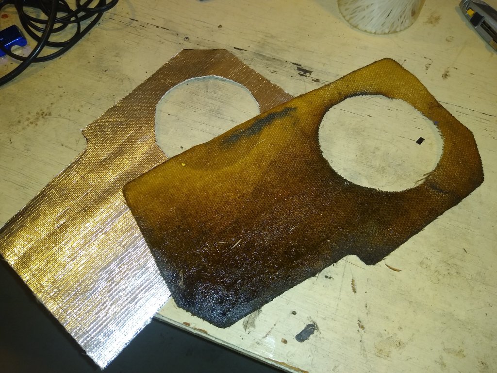

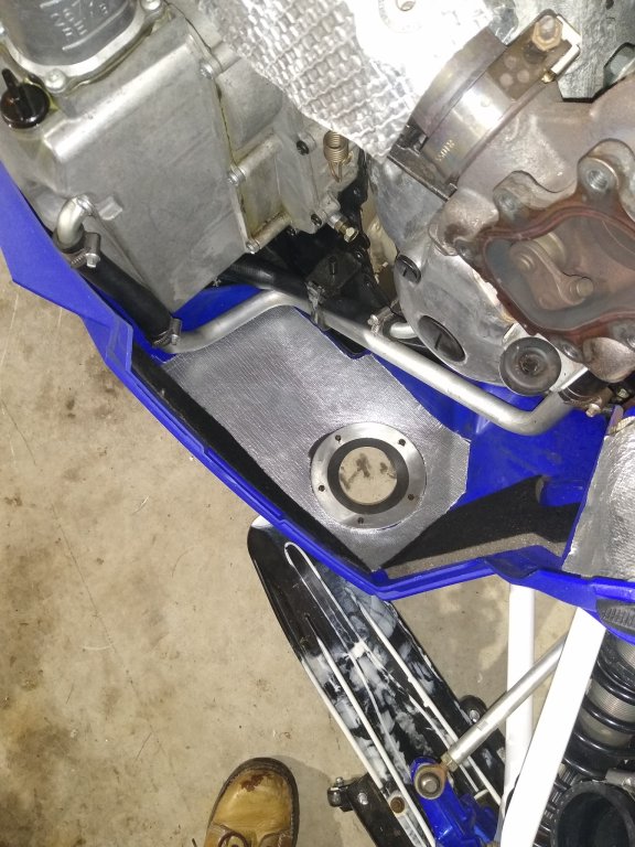

Finally got to fixin' this fire hazard. (Dealer did the first few oil changes) Cleaned everything up with acetone & heated plastic up with heat gun. In hopes it would adhere. It's solid.

Where did you get the heat shielding in a piece that wide?Finally got to fixin' this fire hazard. (Dealer did the first few oil changes) Cleaned everything up with acetone & heated plastic up with heat gun. In hopes it would adhere. It's solid.
		Doc Harley
- Oct 17, 2016
- 3,776
- 1,847
- 1,503
- Here & there
- '17 Sidewinder LTX SE
If you shift this sideways you'll be able to make 3. They will all be an 1 " short.Where did you get the heat shielding in a piece that wide?
Check this out! https://a.co/d/76acI1V

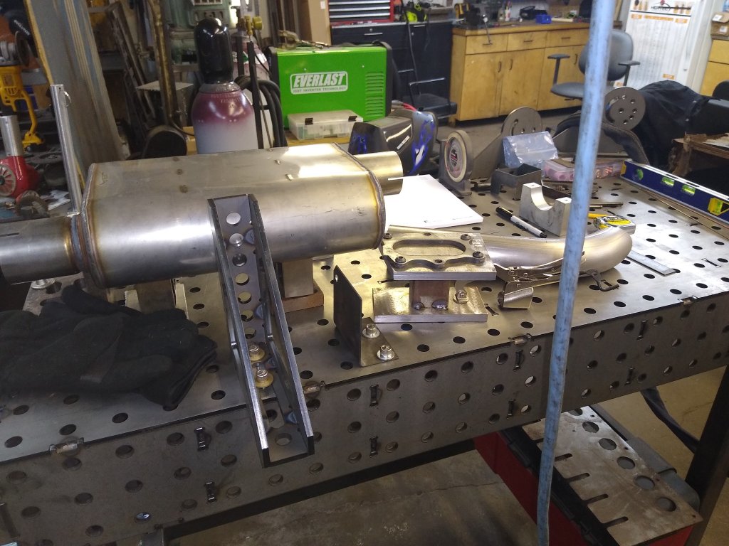

Getting started.... shouldn't be long now

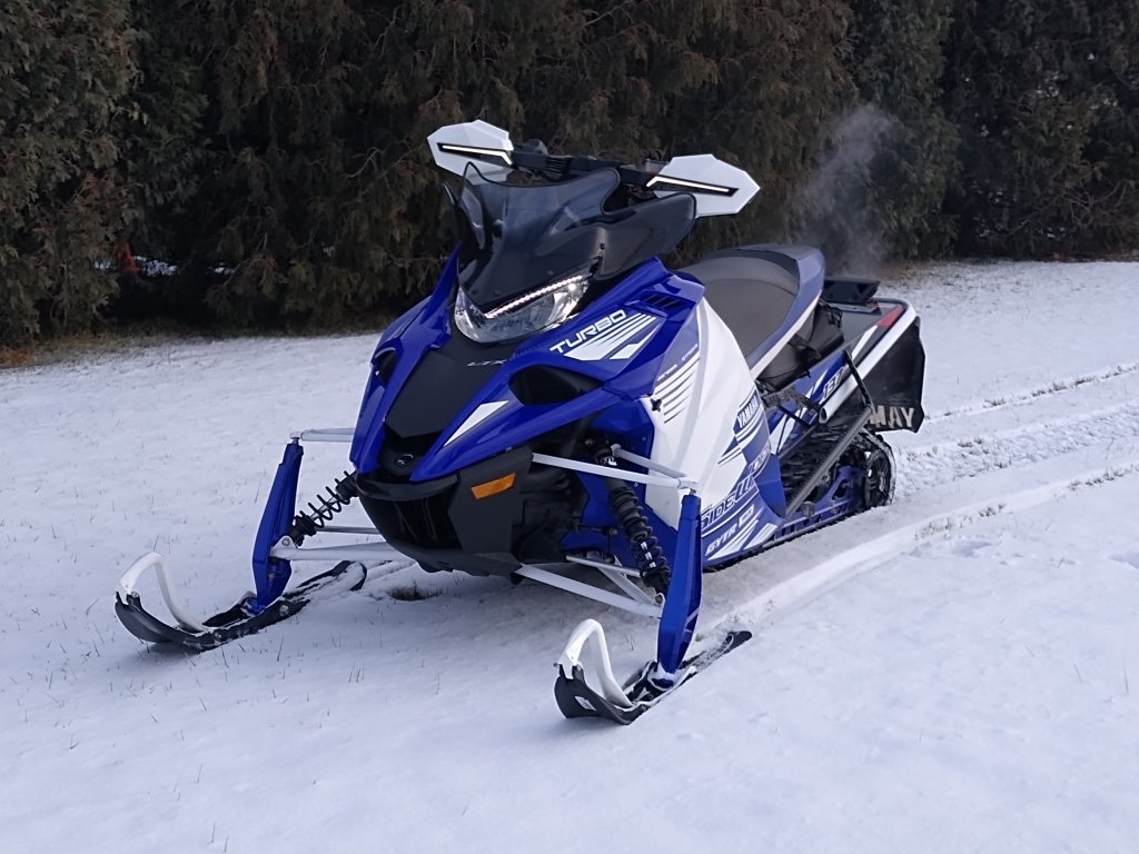

First ride: Max spool 16sm
Made 5-6,7,8 good shakedown runs up to 100mph. Never pulled much more than 3/4 throttle. What was left to the bar was negligible. Whatever?!?!
Guessing 1500ft including shutdown.
Outside temp 19° F
Primary 132°
Secondary 72°
Belt 117°
These clutch & belt temps went up 10°+ after a few more passes. 8jp belt
[ ] Engine 173-177°F
[ ] 15.8+/-psi
[ ] IAT's 58 °+/-
Skis get flighty in the mid range. Was the only thing I observed.
Pic was is the deepest powder I could find 3"+/-. Lol.
