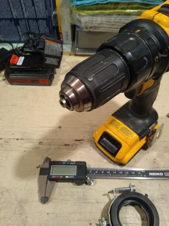

You can't just tighten those clamps to the stock bushings, they will still leak. Not near enough clamping force using the stock spacers. You need to pull the throttle body boots out clamps and all. Take the spacers out and cut them in half so they tighten up on the rubber boots tighter.
And you don't need to remove the fuel rail or anything, just the the regulator off the end so you can pull the throttle bodies up high enough to access the boots.
The Allen wrench needs to be cut much higher than you did. Like 3-4" or so long, not just that little stub you made. You wont be able to use that little short stub to access the screws decent with the socket that close.

Mike....i understand. I made a 4" version of stubby. I was afraid of the part about spinning the clamps downward so once I got them loose, there's no way I'd get the barrels & nuts out without losing them.
I had to face that fact. Gave up, quitter, etc.
I can easily get back to were I was in 30-45mins.
Pull the throttle bodies up, remove the clamps and boots all in one, take each one to the bench one at a time. Easy Peasy.

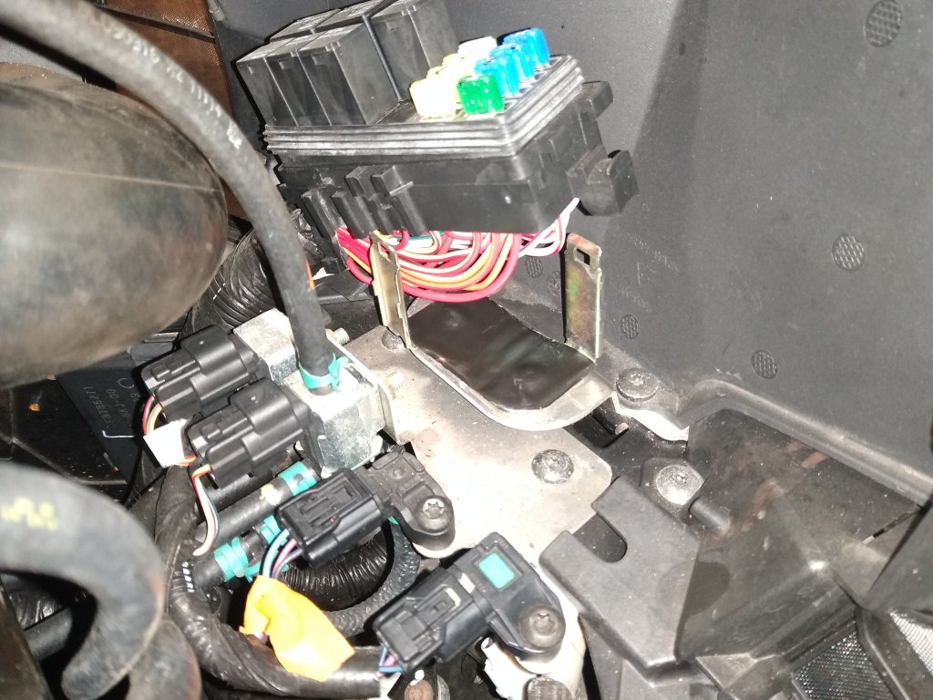

I’d check the wires under the fuse box for rubbing. Easy quick check.
I can see rub marks on the wire casing. No penetrations. But I found a roll of flex tape. Should do the trick.Just jam some rubber under the fusebox. I used a piece of innertube. It will be months before my wife tries to ride her bicycle so all good.

Mike, I quit but didn't give up. Was exactly as you say. Barrels measure .250

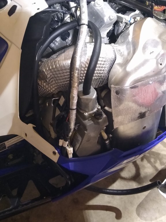

Not finished with ROV delete. Any ideas on an exit strategy. Other than the foot well area. Just asking. I'd like to do a bulkhead fitting with a smooth finish dumping out the bottom. But I know how that goes.....
Made a patch to insulate wires from metal plate.
Turboflash
- Mar 18, 2019
- 2,756
- 2,797
- 1,113
- Southern MN
This is a pic that Knapp posted long ago. Most guys run the return to the outside like this to get it out of the way and to the far right of the footwell.Finished clamps & made a boost leak tester. I'll blow this up this week, just to see. Wait, that didn't come out right. Lol
