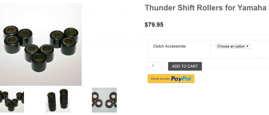

I did look at every roller I read about here, and they were all 79 to 89 bucks.....
Just was surprised someone had some much cheaper....My bud had already bought them, did not even know Hauck was still around these days.
Sorry bout the post, I will remove image Tom.
Those are their primary rollers for Yamaha clutches. The ones for the sidewinder secondary are not on the website yet. You will need to call them to order. They are $45 a set.

I was wondering as they looked to be sized differently then the others ive seen....now that makes sense!Those are their primary rollers for Yamaha clutches. The ones for the sidewinder secondary are not on the website yet. You will need to call them to order. They are $45 a set.

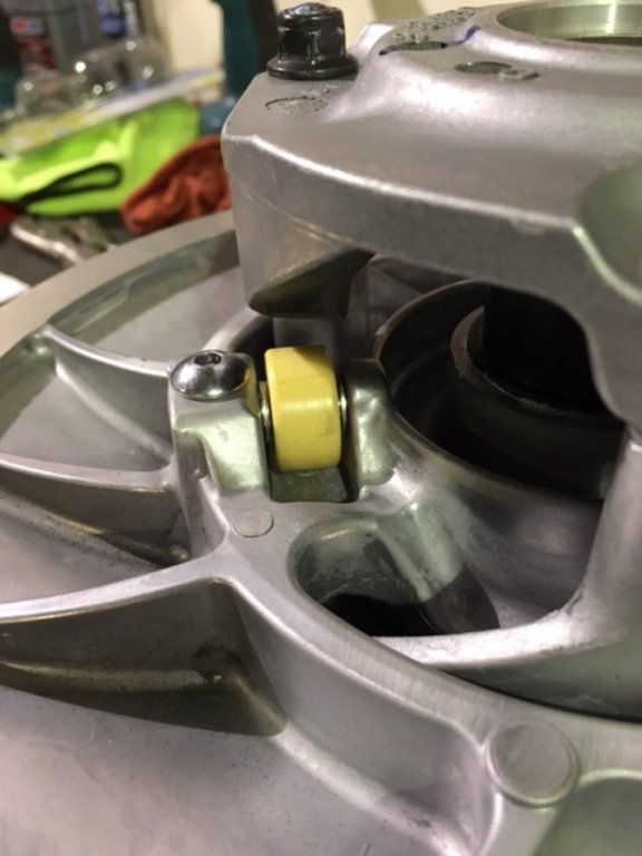

I changed the rollers out with only 2.3 miles on the sled. Probably a very good thing, as one of the "pins" was missing a bit of plating, and was quite rusty. Looks like the pin turned in the bore, as it had a small bit of aluminum transferred on to the pin.
Luckily it had only seen part throttle as I warmed it up around the yard........

I think I like that design better than the wider roller, less friction on the side of the rollers.View attachment 125818 I purchased the Hauck rollers. Not too impressed. They vary in size about 5 thousands from one roller to the next, also about 10 thousands larger than stock. Then you have 3 small washers for shims to put on the sides of the rollers. Not impossible, but more work than should be needed.
With the size differences are all the rollers touching the helix?

I have not assembled it with the spring yet, but I doubt it. Then again the stock rollers didn't all touch either. Hope to assemble it later today.
