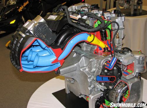

The original problem with doo 4s is an intake that places the TB upwards of 8 inches from the cylinder. Yes I said INCHES!(pic below)...BRP wanted their 4s to be mounted low and in traditional manner(Exh forward), so they had no choice but run the intake runner up overtop of the jackshaft. IMO this is why YAM has always been the only true performance feeling 4s available. Every YAM 4s that has been mounted with intakes out front, and tipped back allows for very good handling even with a higher COG. And most importantly allows for the TB's to be directly bolted to the cyls, making for the best throttle response 4s avail. Not too mention the exhaust goes out the back placing much of the heat in a better location then out in front of engine.I wonder if the iTC will be the next thing the tuners play with. Should be pretty easy compared to hacking the engine management. Example is my Tundra. Back when people were slamming Toyotas into buildings and such and blaming it on the throttle Toyota wanted to reprogram all the drive by wire systems. Keep sending recalls to me to this day. I have driven the reflashed systems and they really are drastic difference but not responsive like mine so I wont do it. I bet Hurricane,TD and Precision will have options for the iTC soon. Cnat see liability being anymore of a issue than there current tunes so why not?
