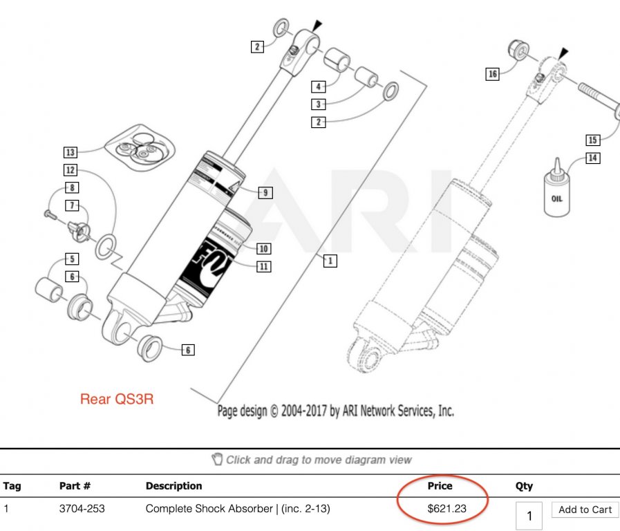

The good center shock is from the YAM LE models(pre-'19). -Dan
Qs3-No rebound w/ kashima.
Here are the others...Qs3r is a much better shock then Qs3(fronts/rear).
5/8" shaft, rebound,Kashima
1/2" shaft,No rebound, No kashima

Thanks Dan, I bought the QS3R's for my front suspension, and would love to have found them for the rear. Are these diagrams and prices from someone who currently has them available for sale?

Personally, I want to ride one of these sleds with standard Qs3's and then QS3R's before I were to drop that kind of jing. I only have an SE, so I have the cheap shocks. I am going to try having them revalved first. If that doesn't make me happy, then I will explore upgrading my shocks.
