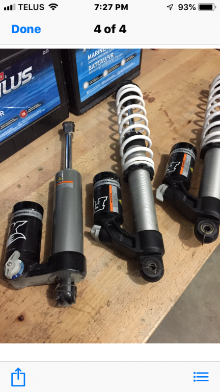

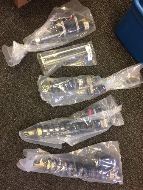

That's a rear shock for a 129, the rez are offset to side of the rear suspension, the 137 shock rez is straight below the main body. You can use your center shock with this setup just have Cannondale revalve it for you and get a better spring.Picked up 3 QS3 shocks two front and 1 front rear skid shock came off a 129 ZR 9000. Going to put them on my 2015 RTX 129 Hurricane turbo 190. Just wondering if I can use my stock rear shock if I send it to Cannondale27 to Re valve.View attachment 147661View attachment 147662 View attachment 147661View attachment 147663

In the photo you can see the difference between the shocks, rear front and rear back. This is a set i purchased new from Hygear for my 14 RTX.Picked up 3 QS3 shocks two front and 1 front rear skid shock came off a 129 ZR 9000. Going to put them on my 2015 RTX 129 Hurricane turbo 190. Just wondering if I can use my stock rear shock if I send it to Cannondale27 to Re valve.View attachment 147661View attachment 147662 View attachment 147661View attachment 147663
Hope it helps.
