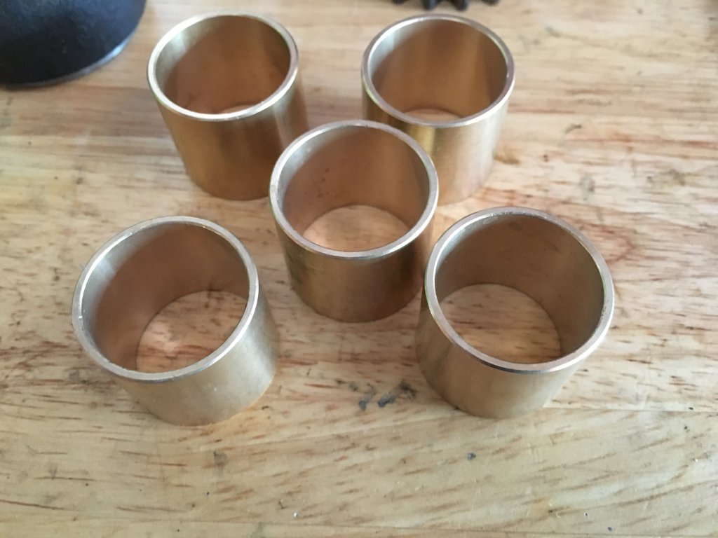

Ended up purchasing bushings from McMaster-Carr part number 6381K563

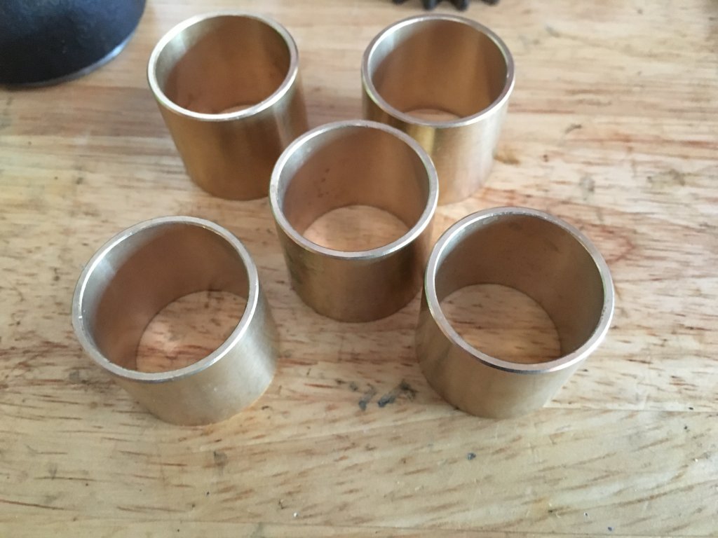

Bushings $3.00 a piece
No ptf coating on them but should work fine.
Did they seem to fit the shaft a bit tighter than stock?Bushings $3.00 a piece
No ptf coating on them but should work fine.View attachment 148699

Have not pressed one in the gear yet but just putting it on the shaft seems tighter.Did they seem to fit the shaft a bit tighter than stock?

Finally got bushings pressed in which I got from McMaster Carr. Had to cut 2mm off the length. Also had to sand inside a bit to slide over jackshaft after being pressed into gear.
